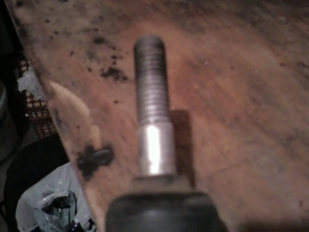

Here's a pic of the bolt, I wanna make it like the others I have seen for Jeeps and such. Which is basically just a hole through the bolt with a cotter pin through it. These shouldnt be a big deal. Anyone have any input? Roadbully I know you're into fabbing, what do you think?

K, I'm sure you have noticed the lack of flex. You put a front tire on a rock and pushes the whole truck up it feels like. That hurts our off road capability. I think this will help. I'm gonna keep mine off for a few days so I can take them to a shop and get a hole drilled just above the top bushing. I'll post pics when I get this done. I'm also putting off the small mods and saving for a locker, limited slip sucks!

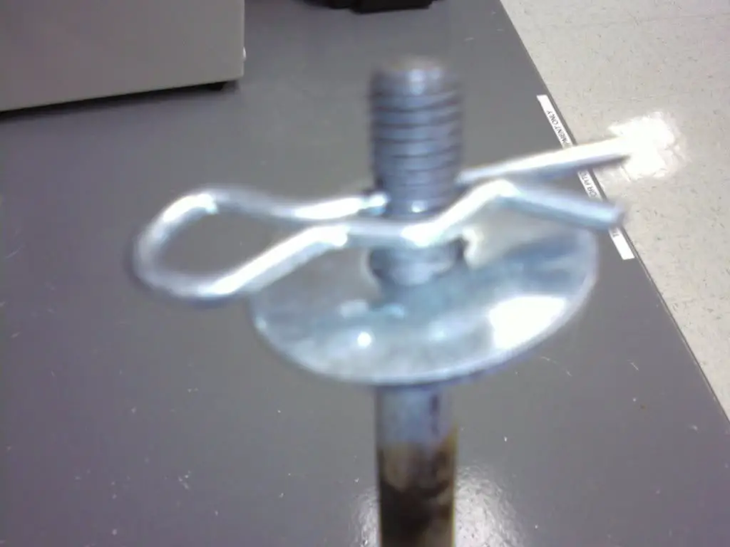

I think I know what you mean, usually as with the type for Jeeps you just have a metal washer over the rubber bushing under the cotter pin.

I did this on mine way back in the day. I just drilled a hole through the bolt and used a pin to disconnect.

Yeah it wasnt hard at all. I didnt even need a drill press, just a regular drill. Where you at in north Georgia? Know of any good trails?

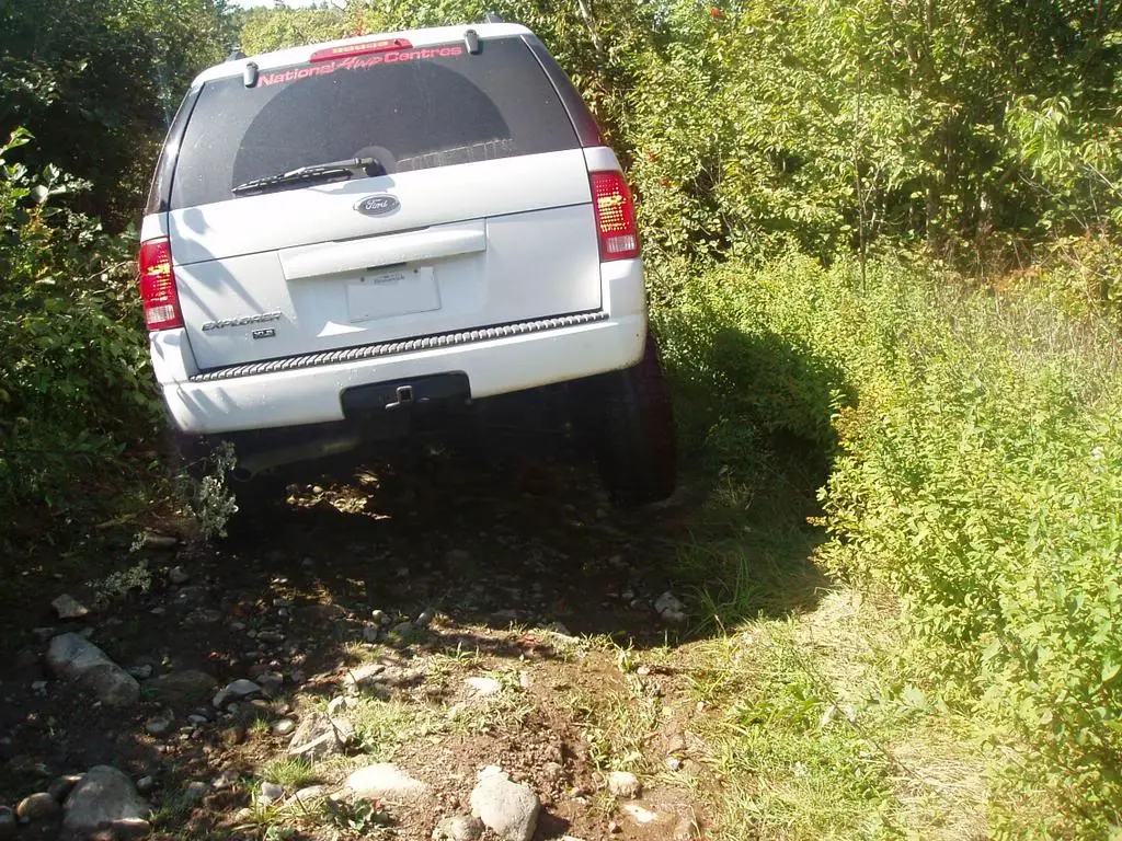

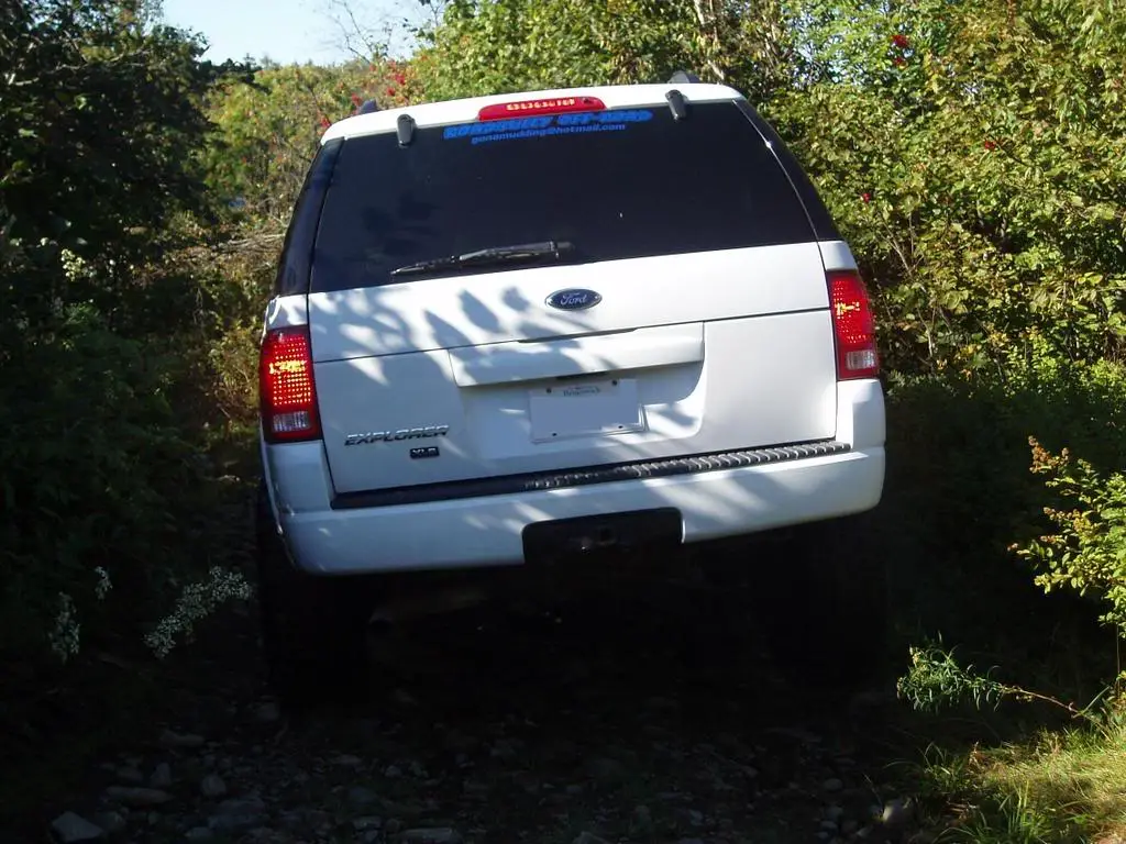

Very bad time of day for these pictures, but it's definitely worth doing the quick disconnects.
The Ex was in the exact same position in both pics, the first day, the rear tire was off the ground a good 6-8 inches... and today, 2-3... :thumbsup:
Before
After
