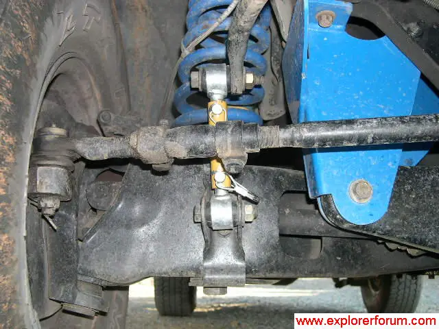

Heres mine:
I would just make them yourself. I spent $10 on front and rear disconnects and about 1 hour spent. It's really easy. I would post some pics, but I don't have any right now.
