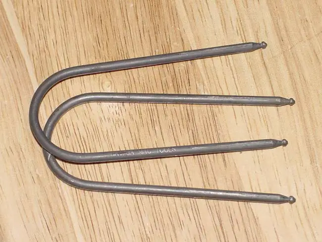

This is the actual tool, if you don't have these I would try nails, as the coat hangers (which is a good idea) aren't as strong and will bend, and aren't as snug of a fit.
These tools, bought off the MAC Tool truck cost $7
