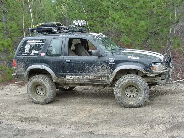

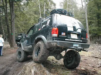

I just say go with the axle swap.... hell, Im runnin 35's now.... without a lift or axle swap.... but gettin ready for the 44 now....
I want the front to flex like this....
looks like 3" BL, SOA,and ultra torsion twist to me. fender trimming too. did you cut just the plastic or the sheetmetal too? Oh here in cali i think a front bumper is neccessary heh. but it looks if you had it on 35s would rub badly
