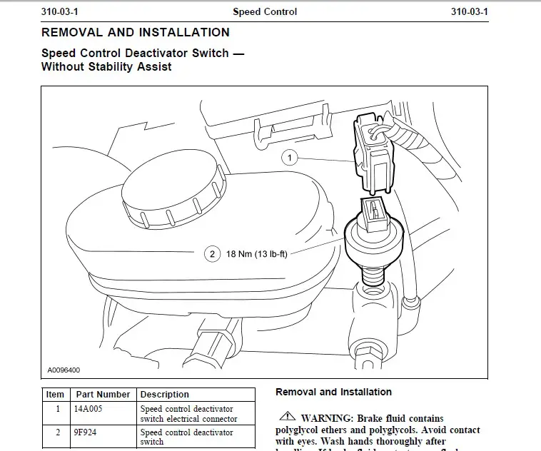

I do believe this is my problem as well and really appreciate the help but just making sure on what everyone is talking about is the senseor conected to wires? what does it look like
sensor
ok so just to make sure what does the sensor on the master cylinder look like and is it located on the side toward the engine?
Its on the front of the MC
Here is what it looks like:
getimage.php
Here is the P/N
MOTORCRAFT Part # SW6349 {#3L3Z9F924AB}
Assy Only, Mounted In Brake Line or Master Cylinder
