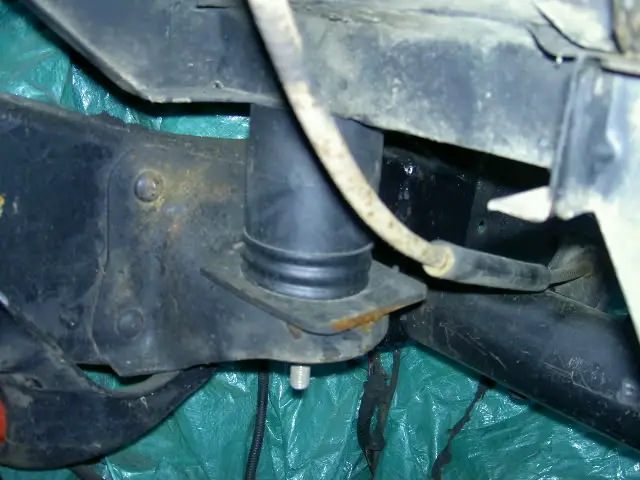

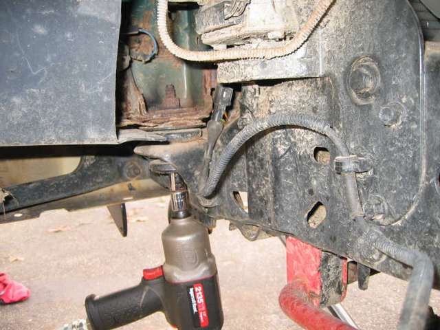

These mounts are different from the other mounts in that their bolts mount from the bottom instead of the top and more importantly the upper flanged washer is also threaded. I soaked the threads with PB Blaster and used an impact gun to work the bolt loose (1st pic). The bolt would only come out a few threads before getting stuck. I would soak all exposed threads tighten the bolt and then loosen it. After a few minutes This back and forth motion eventually exposed the lower threads. I soaked them and repeated the process until the bolt was extracted (total time 10 min). In the 2nd pic the lower bushing is removed. I then used a 1/2" Cobalt drill bit to drill through the center of the mount (using WD-40 as a lubricant) to clear the way for the replacement 1/2" bolt.
