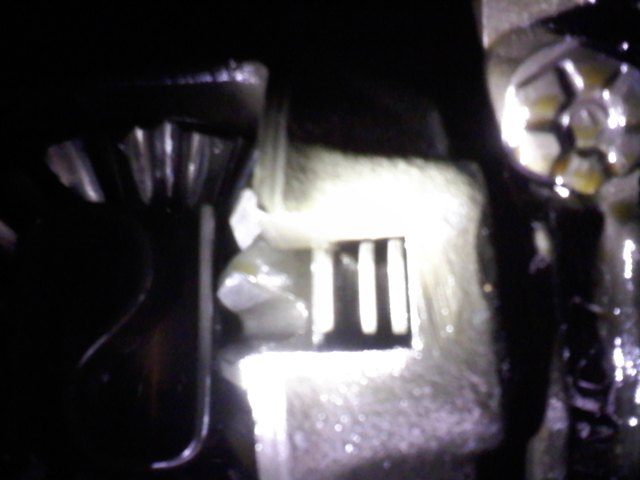

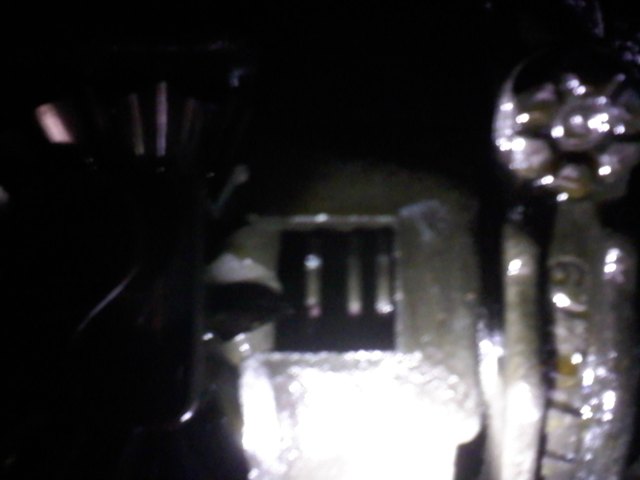

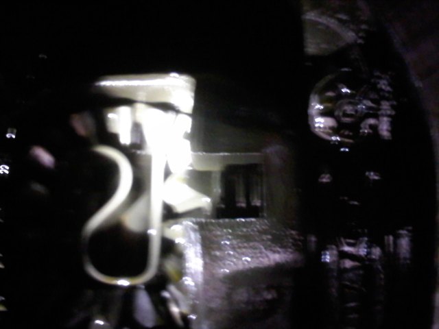

Can anyone tell if the friction disks are worn from these pictures? I think that it is and or is on its way out. You can see that there is different spacing between the tabs, and it looks like where the tabs are closer that you can see the disks and it there isn't much left of them on two. Unless they are supposed to be that way. Anyways if anyone can tell let me know? You can see the difference between the red and yellow arrows.
