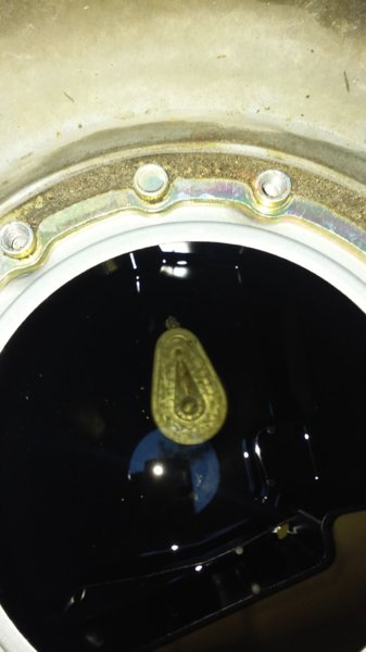

The fpr is in the tank on the pump the fuel rail damper is on the drivers side back of the fuel rail with a vacuum line on it
Here is a pic of inside the tank and the pump arrow pointing to the fuel pressure regulator
And a link to the thread when I fixed it Is my fuel pump bad 1999 ford explorer shoc 4.0. Lots of pictures on the replacement
Repair starts a post#36 but if you want to read about all the trouble shooting start on page 1 I would but I like to read
Here is a pic of inside the tank and the pump arrow pointing to the fuel pressure regulator.......
