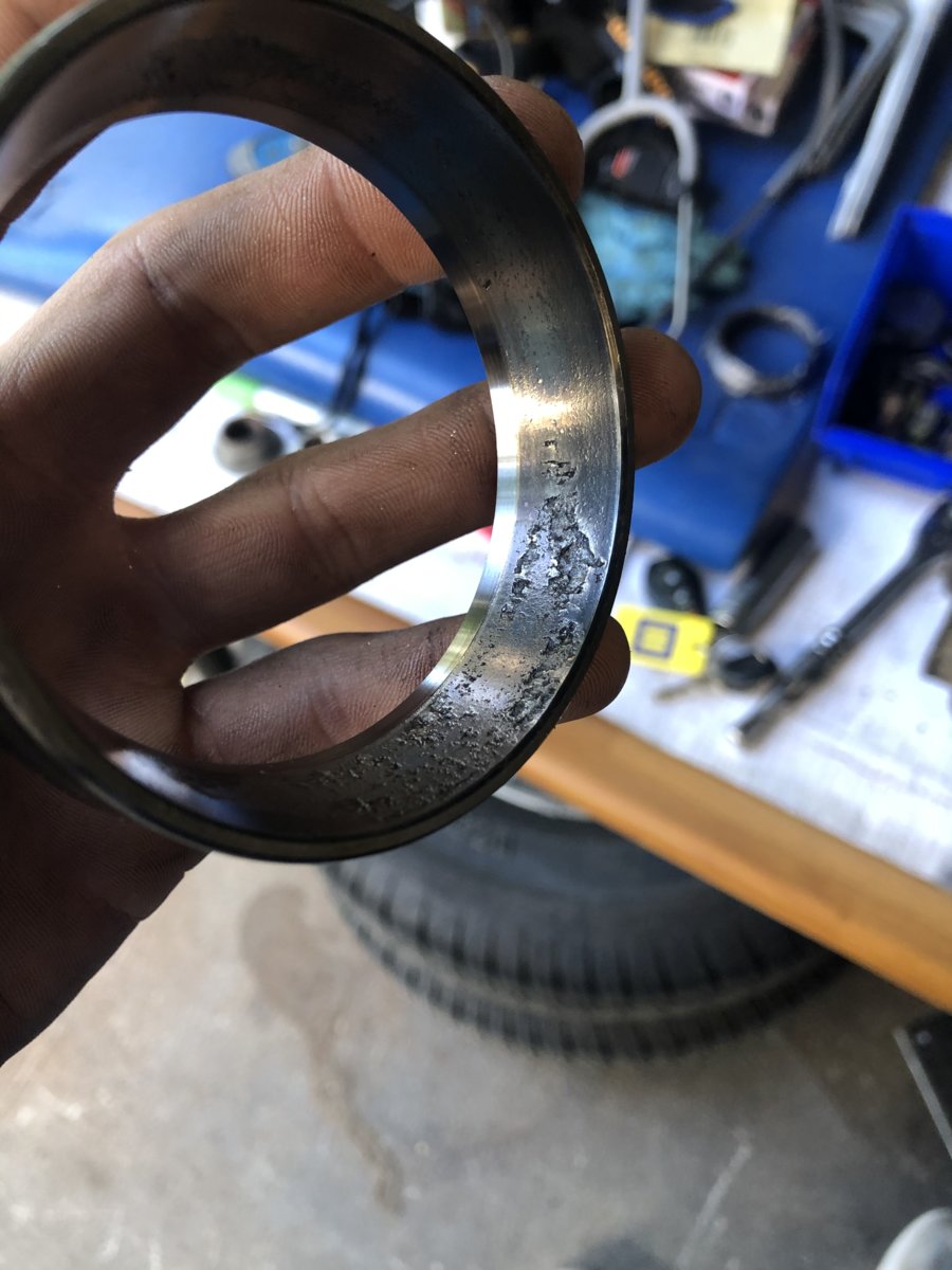

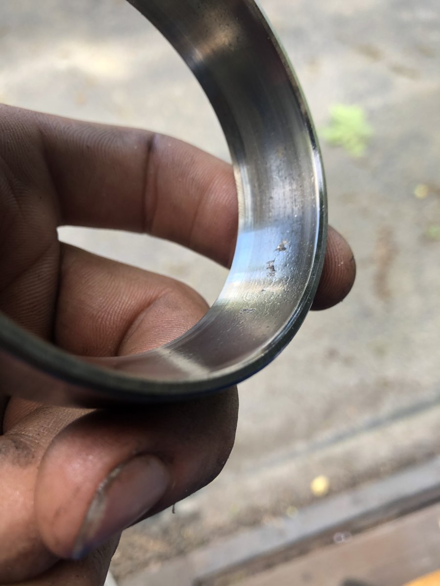

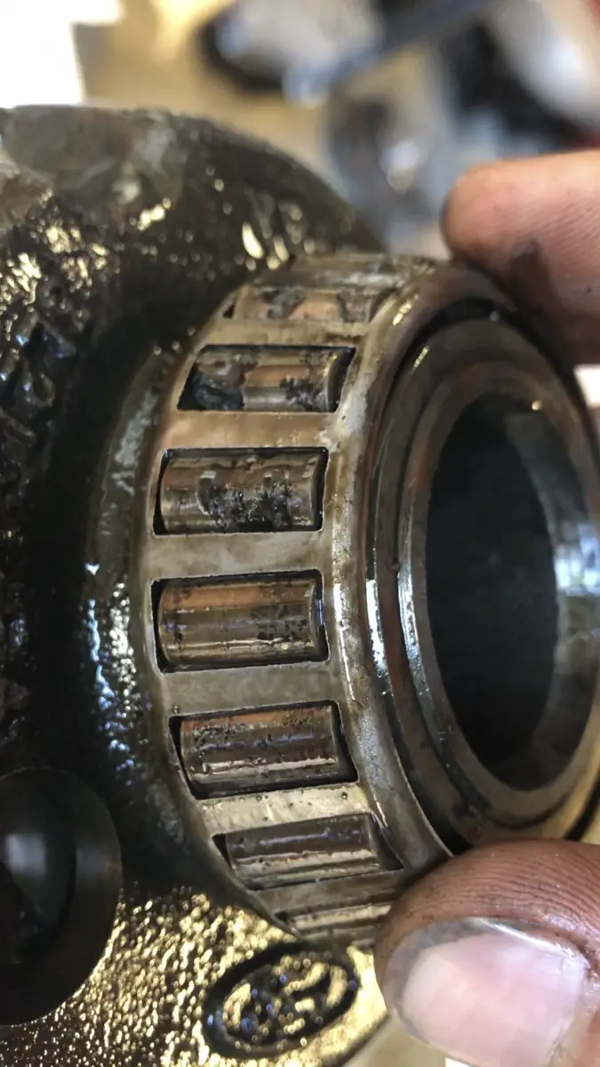

Found the culprit, both carrier bearings need replaced but primarily the passenger side one it’s pretty toast. The race is fairly pitted and little bits of the bearing have come apart as well which leads me to my next question. Seems the ring gear has some very slight pitting in this one isolated area of maybe 3-4 teeth the rest of it seems unscathed, pinion gear also good, so is it okay to reuse these or would it be wise to just order new gears? COVID-19 has put a little damper on my disposable income at the moment so spending another $100 on gears is not ideal rn. But did a lot of research on the rebuild as well, I also have alldata manuals for all my cars so I’ve been reading through that as well. Feeling very confident about it now but might just order some extra crush sleeves and an extra pinion nut in case since it is my first time.
Edit: uploaded some pictures too, the driver side had just a little spot in it and then the passenger side...
Well it's always a good idea to get new ring gears if there is any damage but if you think it's ok then just go for it....

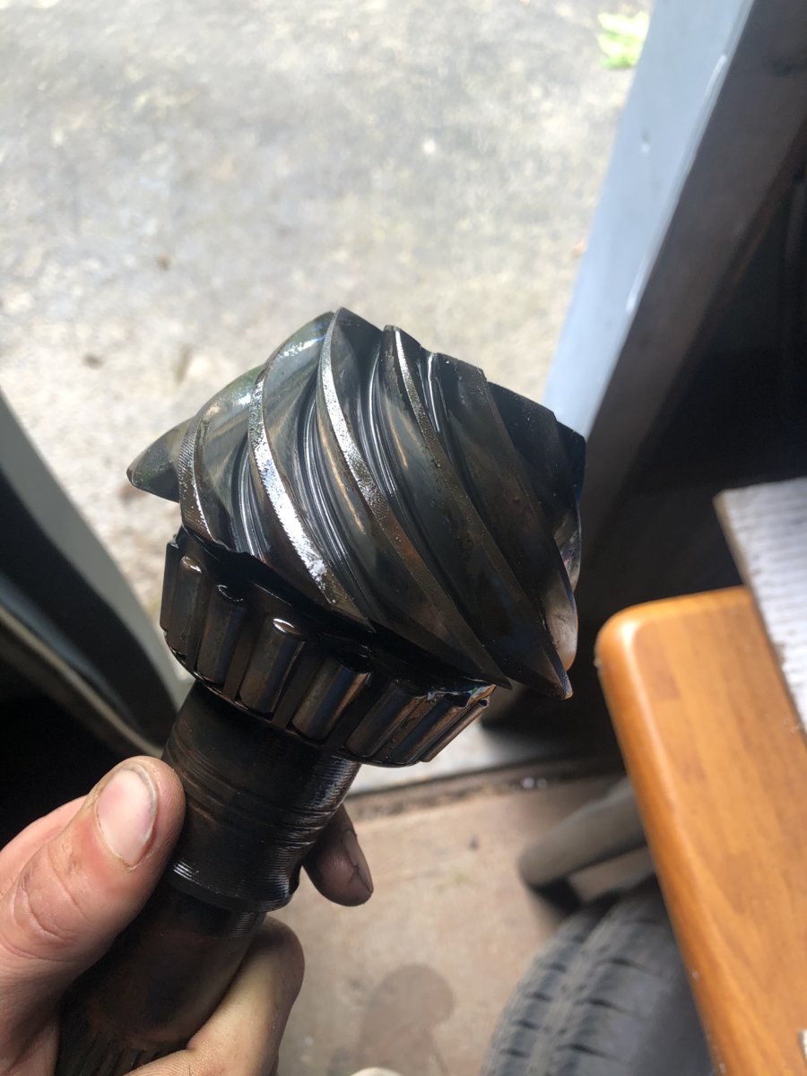

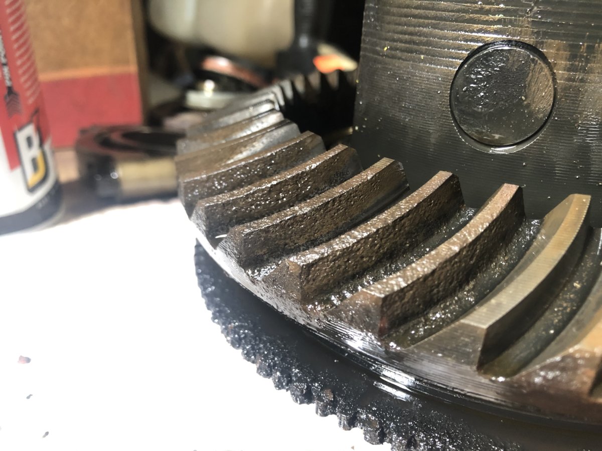

Alright I’ll get a couple pictures of them when I get back to the garage, see what you think
Only spot on ring gear that looks like that and the pinion gear looks like that all the way around but looking at that picture of the ring gear now it looks a little bit worse than I originally thought so I’ll probably just bite the bullet and order new gears as well.
Yes you going to need a new set...

yeah I’d go all new on the rebuild. You don’t want to get it all buttoned up and have problems. First thing you think is I probably should have replaced that ring. How much extra to do everything?
Exactly what I was thinking so I just bit the bullet and ordered everything. Total from rock auto was $514...sigh
