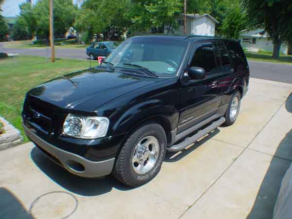

Originally posted by Black Magic
I ended up just using 1" blocks in the rear. With the lowering I did up front It looks nice and level.
Wow, BM, your truck looks naked on that picture there! :D
BM and Hartman pretty much covered all your questions but I'll add that if you lower your truck more than 2" in the front, the shops won't be able to get it to align properly even after installing the eccentric camber kit. Mine sits 2.25" lower and I have -1.3 camber. Not good.
