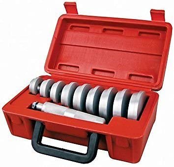

Looking to borrow or rent a rear main seal installer tool for a 4.0 V6 2002 we will pay shipping and rent get back to me please
Have you tried a local auto store?
$25.99 at Amazon
NOTE: Also SHIPS from AMAZON so you will get it quickly.
LINK: https://www.amazon.com/dp/B01GVQOSA4/?tag=serious-20
I use a PVC endcap. Really cheap and always available at Home Depot/Lowe's
I've seen mechanics pull the old seal out and use it to tap the new one in. They are the same size.
