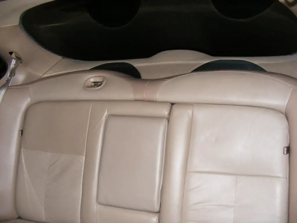

The black carpeting on anything looks good with the contrast. Speaker grilles, etc. like I did in my SHO look good...
painting random interior parts is where I get lost, some look cheesy if not picked right, but hey- nobody can tell you what looks good in your ride- it's your car. I'm sure I've done some things that people say "huh?" when they see it. :)
I put black carpeting in my '88 Mustang racecar, and that looks much better to me. Nice contrast to the other black parts.
Terrible- the only interior pic I have is of the hatch section! Get the gist though... :D
