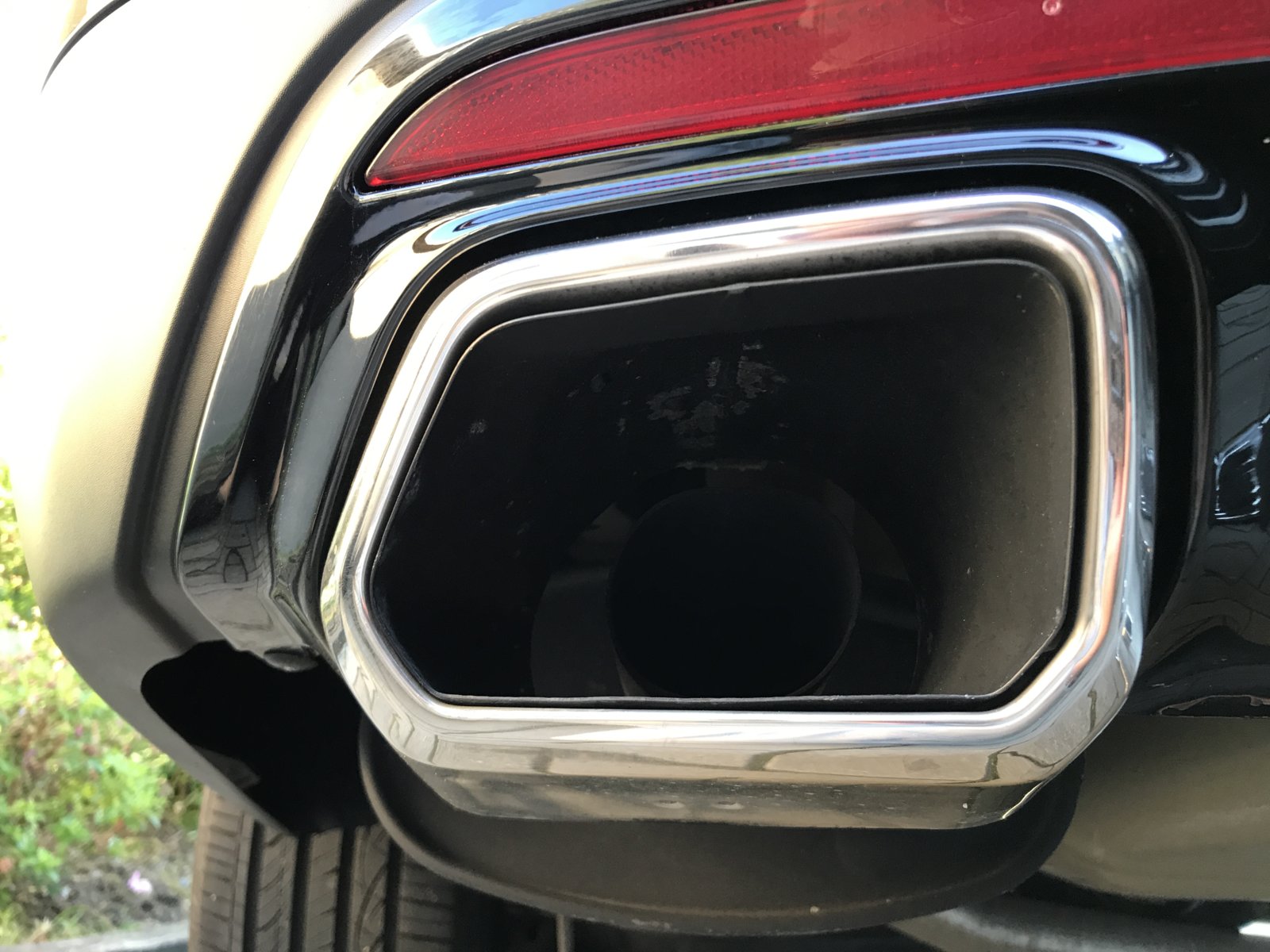

I did a search but I cant find any.. Going to be doing the exhaust soon and I am considering the removal of the stock tips and doing a quad exhaust setup (like the 2018 sport). Does anyone have pics of what it looks like with the tips removed from the bumper? Is it even possible?
Thanks.
If you are referring to the chrome piece in the bumper cutout, yes, it can be removed. I believe one of the members replaced it with a black one. If you are thinking of using those existing openings for a quad exhaust, better look again. I doubt that you can fit 2 pipes next to each other.

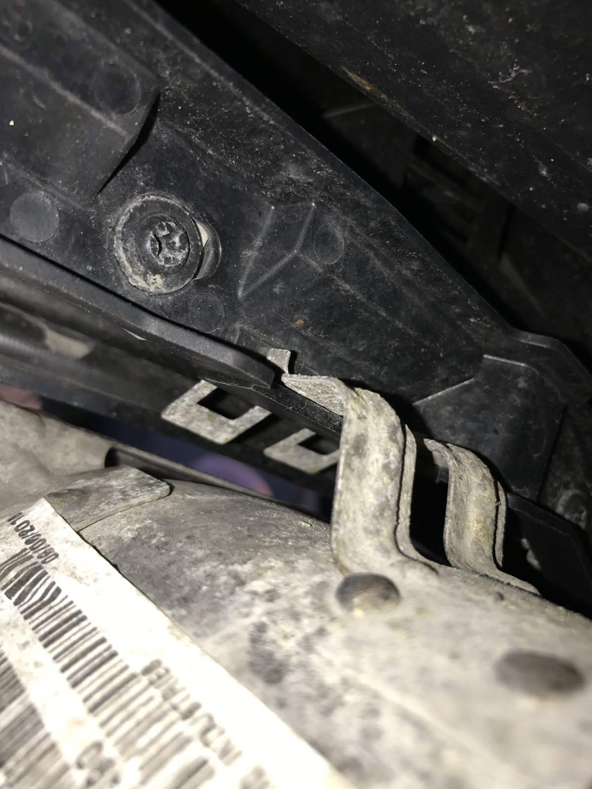

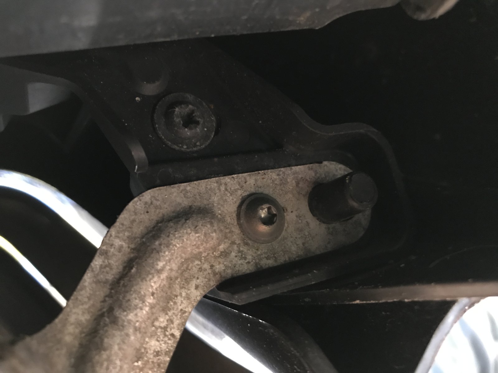

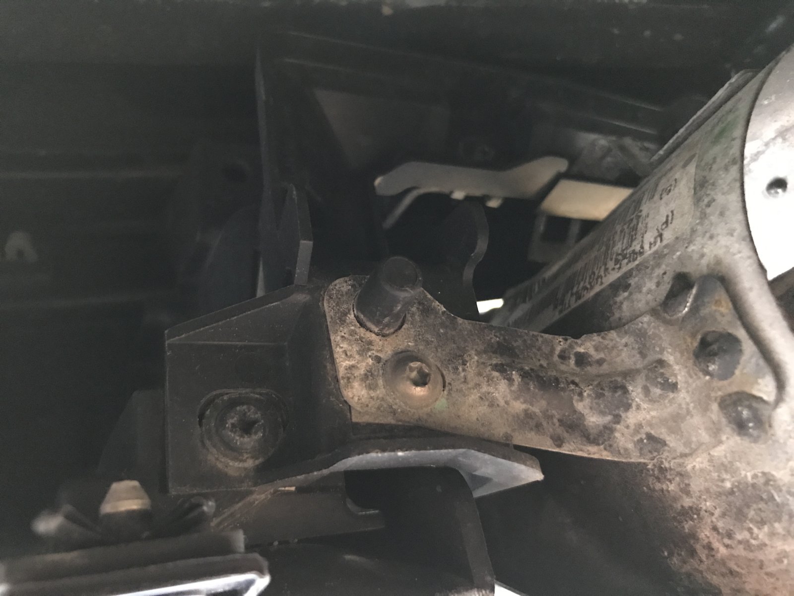

Thank you for the links, that is close to what I am looking for... I WAS referring to the chrome trim piece. My main concern is if I remove it will it be a clean cut out or are there screw holes/mounting tabs visible from the back after the trim removal
Sorry for picture duplication, not sure how to delete photos with this new direct copy system
As you can see the trim rings have two side tabs and two top tabs all hidden from view. The two side tabs have TORX screws and the top tabs just need to be bent straight and they slide out. No holes visible from the rear of the vehicle.
