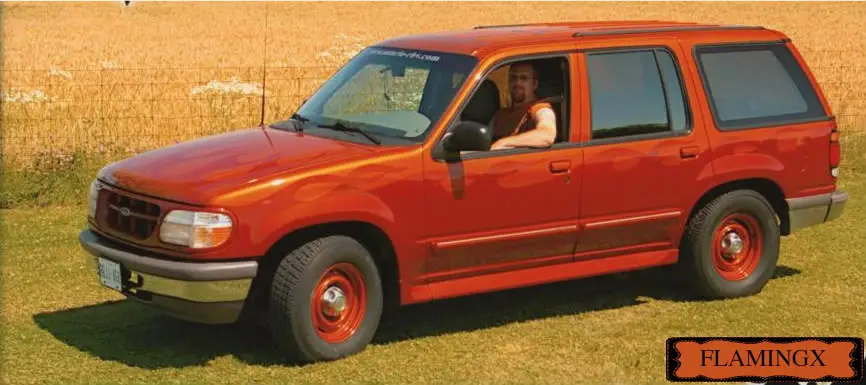

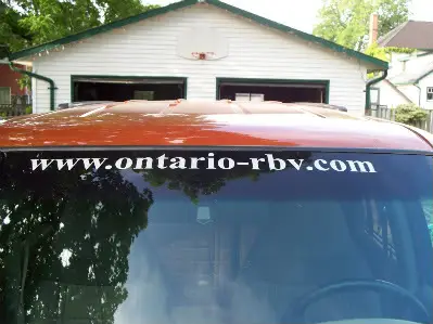

I'll will be doing my '97 (same roof and rack) within the next month or so. I'll be welding up all the mounting holes and eliminating all the grooves in the roof at the same time.
But if you dont want to do all that work you can do what I did the last time i painted mine, I just removed the cross bars, left the all the lengthwise ones and painted the plastic ones body color. Still looked 10x better
Sorry couldn't find any better pics of the roof and right now everthing is stripped off of it so I cant take new ones.
