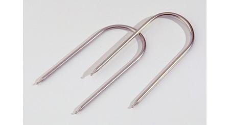

There are 2 screws under the radio on the trim panel.. Remove those and pull the trim panel. Also to remove the radio you need the radio removal tool and you'll need a double din receiver kit.
Radio removal tool

Removing the bezel first will give you access, but it's a royal pain... get the tools. The right tool for the job always makes it easier. Push them in 'til they click, pry them apart from each other, and slide the stereo out. Any other method is a royal pain.
