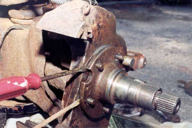

The spindle
The lip of the spindle (which passes through the steering knuckle) will give you the most grief (unless you live in a dry climate) I had tried the "Tapping" method, but after 2 hours of beating the crap out of the spindle with a dead blow rubber mallet it didn't move. I then used a hammer to drive several screwdrivers as wedges between the spindle and steering knuckle. You can't just drive them in, but you have to walk it around the perimeter of the spindle Multiple times until you have enough clearance to drive one in a little. It took about 1/2 hour+ per spindle but it worked. I have since found the ideal method of using a slide hammer.. You put the hub axle nut back on and a few pulls later the spindle is out..

The spindle

I'm having the hardest time getting the axle spindle off, is a slide hammer going to work better than the screw driver method? Does it help to heat it while you do it?
The slide hammer is the preferred method and works like a dream! A few easy pulls and the spindle will be in your hand... most autoparts stores carry them as a free rental (just leave a deposit)

Go get the Slide hammer and spindle Socket, It's so much easier then beating the Spindle with screw drivers and chisels.
You can be there for hours trying to get the rusted mating surface to let go vs three pulls on the slide hammer.
