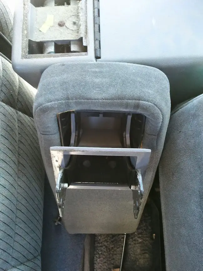

I have a 1994 ford explorer sport and ive been thinking about trying to replace the padding since mine, some how, has seemed to have absolutely no padding in the only area i place my arm, but when i went to go look at it i cant seem to find out exactly how to get this part off and get the fabric off, i have looked all over youtube and google and havent been able to find any how to's, is it possible to replace it or do i have to just go buy a new armrest? this is my daily driver and im in it quite often so it gets annoying having just hard plastic there.
Can you take a picture and show us what it looks like?
this isnt the inside of mine but this is pretty much exactly what the inside of it looks like, the top of the armrest where its towards the driver side top is where its all messed up i just need to know if it is possible to get the top fabric off to get to the foam inside to replace it. ill try to get a pic of mine in the morning if needed.
so i need help, i figured out how to get it off of the center console, i just need to know how to take off the hinge part off, so i can get the plastic off, so i can get the fabric off.

The one's in the sports are rubber, but they are easy to disassemble to re-upholster.
My Ex is a Limited, so I wanted to do it in leather like the original.
But there was no way to do it with the original arm rest. The original is machine pressed together and cannot be redone. At least not without some serious modification.
You can find an exact match for the fabric at an upholstery fabric store.

Any interior stuff from a second gen will fit the first gen.

The second gen center console arm rest uses the same mounting bracket and hinge as the first gen.
It is not necessary to replace the whole console.
It is a direct replacement.
If you figured out how to remove yours, then you should have no trouble getting a second gen from a donor at the junk yard, and just bolt it in.
