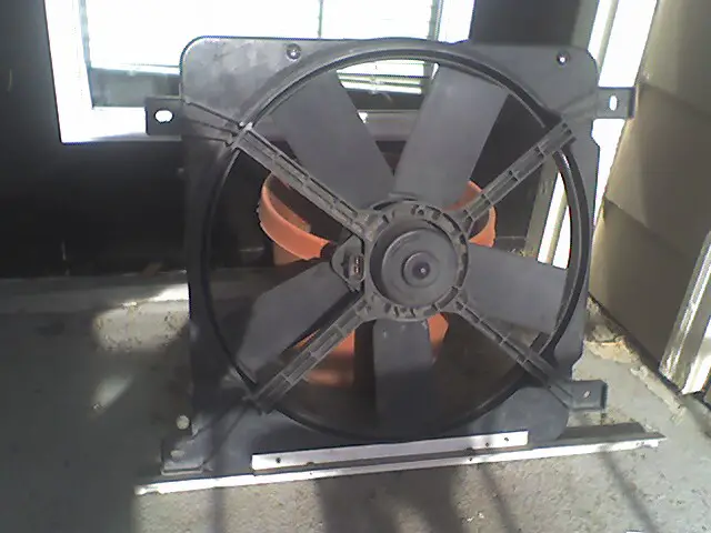

I am using the fan and shroud from a 1992 Buick Century. I chose it at the time because it fit the space constraints as well as being quiet.
The Explorer goes from 40 degrees to about 70-75 degree A/C output in slow speed traffic, with engine temps ranging from 210 to 240 when it's 100 degrees ambient as observed on the overhead console.
With the clutch fan, engine never gets over 205, a/c output stays around 40-50 degrees in stop and go traffic.
This is my e-fan. I made a bracket that fits on the bottom and it sits across the lower clips that hold the fan shroud on, the top bolts to existing holes in the top core reinforcement. Covers about 70% of the surface area. I have no idea what the CFM is.
It's 17.5 inches across.
