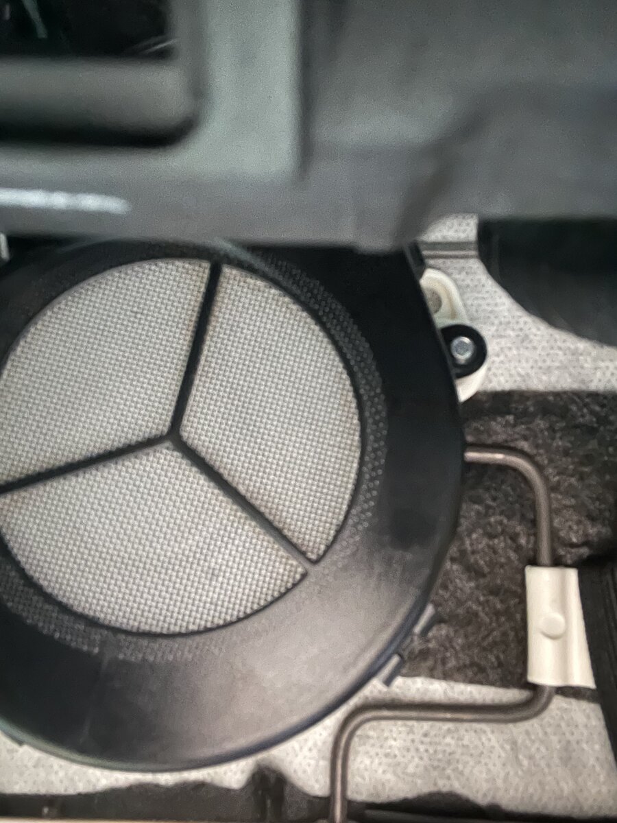

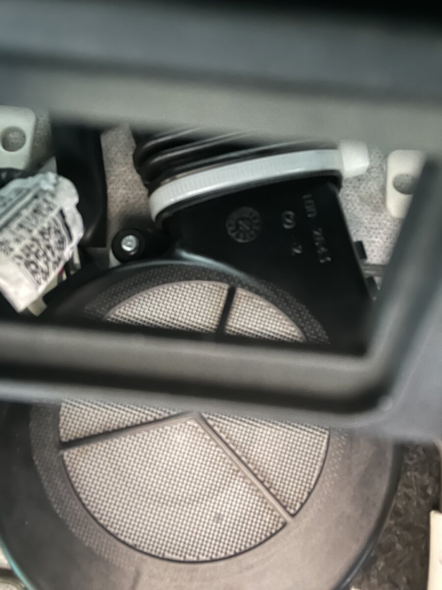

I have a 2016 Ford Explorer Limited. I was told I needed to replace the heat filters since I have 115,000 miles on the vehicle. I do use these quite extensively. I can’t seem to figure out how to get them off. They are in a tight spot behind the front driver seat.
5CFE23EB-14B1-4FF4-AF0F-460871E141E8.jpeg 198EA586-3546-4E50-828F-8798D06A5114.jpeg

Thanks, I had though they changed the design on them, they should have listed them as a different part number and changed the box label if they are going to change them to lifetime filters. FS104LT would have been a good way to labeled them as a replacement part and would have let us know that these are acceptable alternative to the old part.
I got mine from o'rielly auto parts. Same motorcraft # about $29 each. However if you hardly ever use them like my wife, just remove and inspect as they are probably fine.
I sent back the ones I ordered. As you can see in the picture they are still in good conditions and I just took a vaccum hose to them to suck up any dust that might still be present. I will just keep checking every 15k miles or so to make sure, its not like they are hard to take off and put back on.

Your thread was merged with this existing one. According to your Owner's Manual, the filters do not require replacement.
Climate Controlled Seat Air Filter
Replacement
Your vehicle is equipped with lifetime air
filters that are integrated with the seats.
Regular maintenance or replacement is
not required
