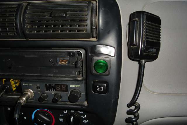

I no longer needed my rear wiper and used the hole for a switch I needed.
