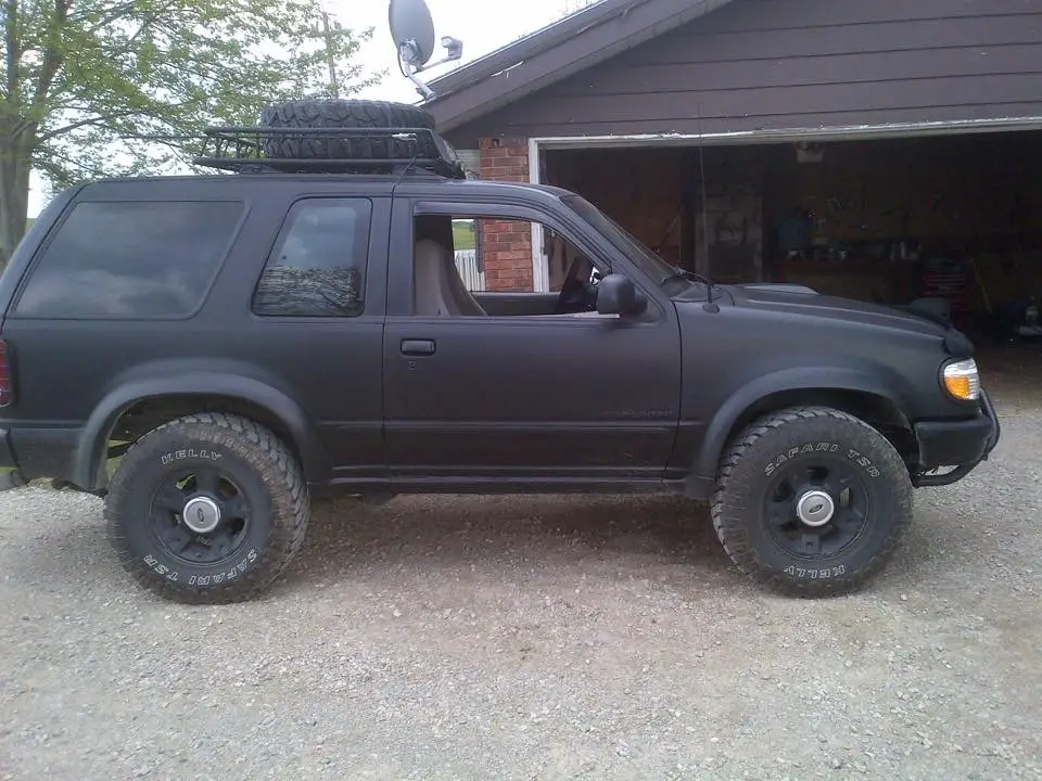

This was my old gal right after I dipped it.
About $150 Canadian but stripping it all this summer and painting Od green , it stains bad with the dirt and peels would be ok for a street truck
$150.00 CAD is cheap... haha thats not bad at all... what plasti dip did you use?
Looks good. What kind of prep work is involved in the dipping process? What kind of dip did you use?
Actual Plasti dip cans from Lowes. I just gave her a good wash and went at it , then peeled off from windows and lights, I tried to mask off but couldn't get a clean edge so just sprayed over edges then peeled back to that edge
Nice. So rattle can a clean truck, and peel it off the windows and such... nice!! I was thinking about repainting.. but its bloody expensive and requires a lot of sanding.... I think I will bedliner the bottom and plastidip the top :)
How difficult was it to get a even coat on that? Im not great at spray painting things, but Im willing to give it a shot... bc unlike paint you can peel it off really easy :)
I apologize for thread Highjacking guys... If I need help I will pm from now on ok?
It's easy to spray as long as u have a good nozzle I had two bad cans I just switched nozzles, just do a light coat all over then a good heavier second coat
It will look textured until it dries then smooths out
How many coats. cans did it take?
8 cans I believe from the Bedliner up
