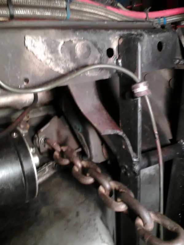

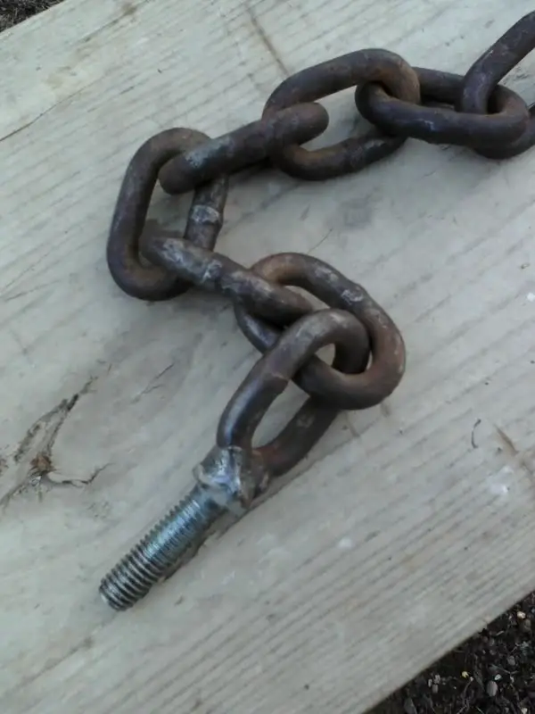

Going to have to come up with some torque control stuff.
What I did was to take the motor mount bolt out and weld a heavy chain to it.
Then find appropriate socket to reinstall. In this case a 1and 1/8" socket.
Then bolt back on block.
Oh ya, this was done on both sides, but it was reverse that was the worst.
Then bolt other end to frame near the modified engine cross member. This reminds me that I have to finish the brace so I can remove it for easy oil pan removale with out raising engine or pulling it so I can check engine bearings and fix an oil pan leak. This way I can just remove pan by taking off the engine brace bracket and pull from bottom.
This 302 just produces gobs of torque with the Edelbrock heads with the large 2.02 intakes and large Ex valves and short runners for low end torque. Then add the Comp cam for additional low torque and this thing is a beast when I shift the Atlas in low and go from Neutral to D or R. I mean it wants to twist the motor out of there ha ha.
I contacted Advance about it and asked about how I read on another site that someone put a torque control connected to the case and they quickly said Do Not Do That. So Plan B was initiated.
Now for the fun part...go out and see If I can twist the motor out of the engine bay on some trails.
you really should only need the left side. how about just do the left side drive it and then hook up the right side to tell us how much more benefit it gives.
The only force moving the motor to the left would be deceleration.
I have done this on a couple of hot rods over the years. need to do this on my bronco for off road as I can see my shift lever moving around.
Was waiting to see if any one picked up on that.
In my Hot Rod days, yes the only side that I ever done was the Left side.
But the problem with this Trail truck once I have it in the really Low range due to the Atlas and I shift into Reverse, Ouch you ought to see the shifters move the opposite way it does from Drive once the Atlas is engaged.
I just tested it in the garage once I selected the Low range in the Atlas. Really smooth now, no jerking the whole engine over or shifting handles moving like it used to.
Now when in the Atlas is in High there was no problem with reverse, just your normal movement, but Low is a totally different animal.
Now I may be wrong on this, but I think reverse is a lower gear then drive in the tranny or most all trannies.

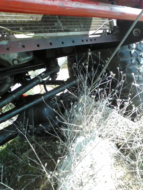

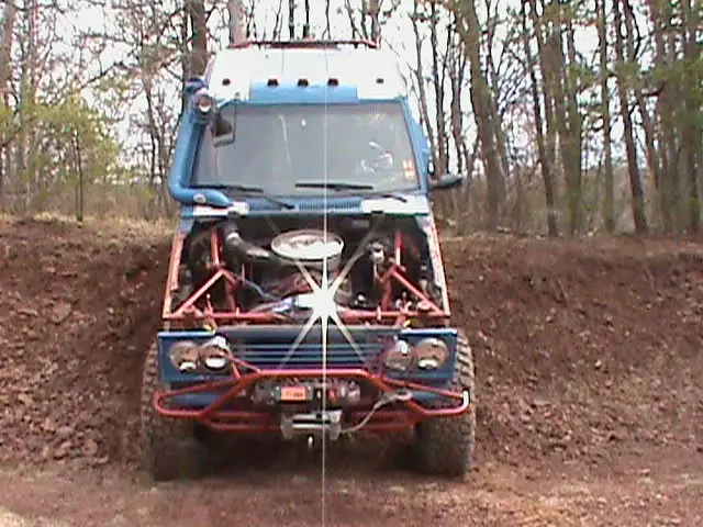

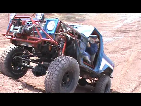

Took Samson out to do a final test on the chain thing by placing diff guard up against rocks and pressing on the loud peddle. Nothing but dirt flying.
Then it did dislodge the rock and this was going up hill.
Two things that take a beating on this truck are, the diff guard and the lower bracket holding the lower link. The diff cover would have been damaged long ago if it was not for the guard. And the leading edge of the lower brackets are banged up but doing fine which point to the integrety of the welds. Now I don't purposely slam into a rocks either.

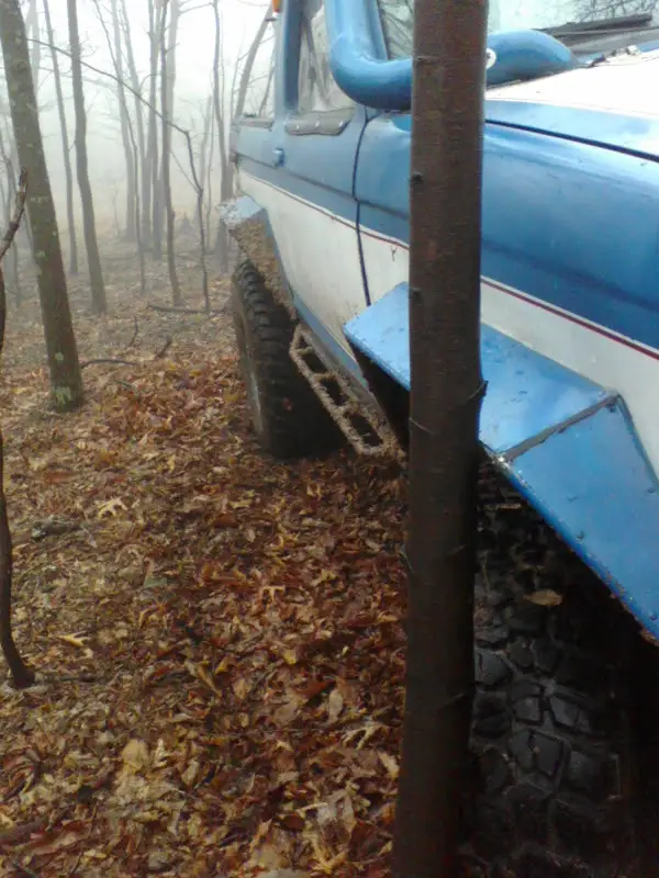

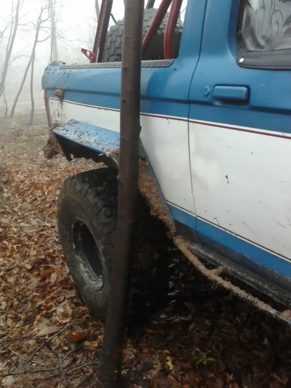

Was a little foggy out at the top of the mountain this morning. Trying to get to those rocks for some fun. There was no trails to get there so I was dodging those little trees.
Back tube flairs held up OK sliding the trees around the fender.
Front was doing well...

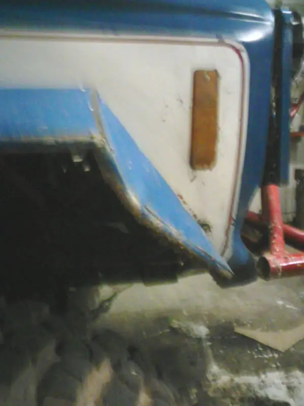

What's wrong with this pic? Other then the dented front fender. It's still on the truck, that's whats wrong. Spent all that time making those removable fenders, but thought that my superior driving would make it thru...right.
And when I got there, I realized not even rigs from the Hammers was going to make it up that wall of rocks.
Would not want to be sticking my hands in those cracks while they're still denned up :eek:

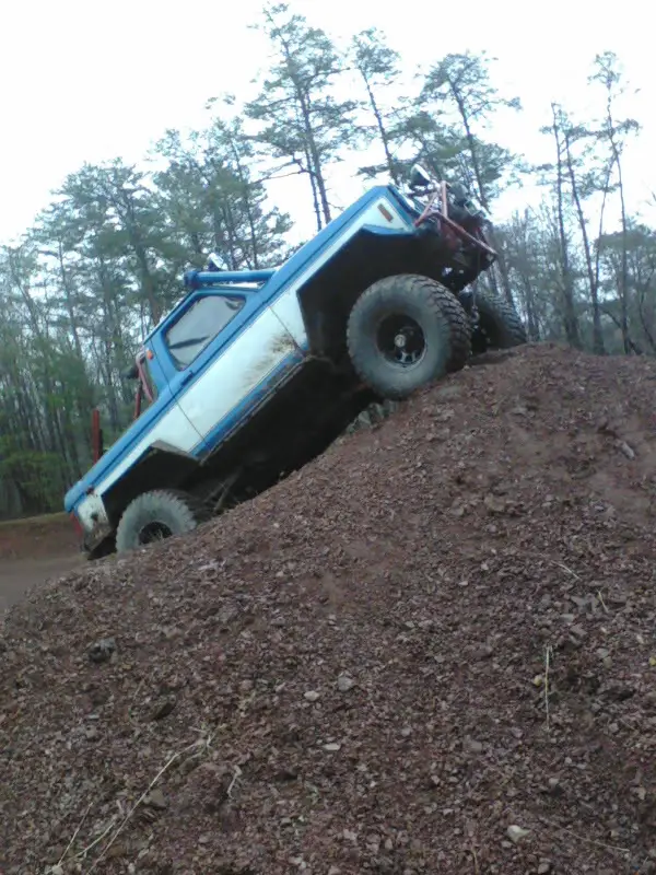

About to break over the top.
I thought it would be slick with the rain, but the little rain made the texture even more favorable for climbing.
The above vid is more for documentation then anything else.

Darn power steering pump.
Nothing a little hammer won't cure, but does have me thinking about a little exo tubed fender work Hmm. Something that I could still remove fender also.

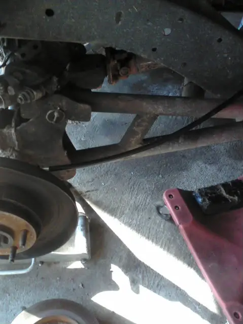

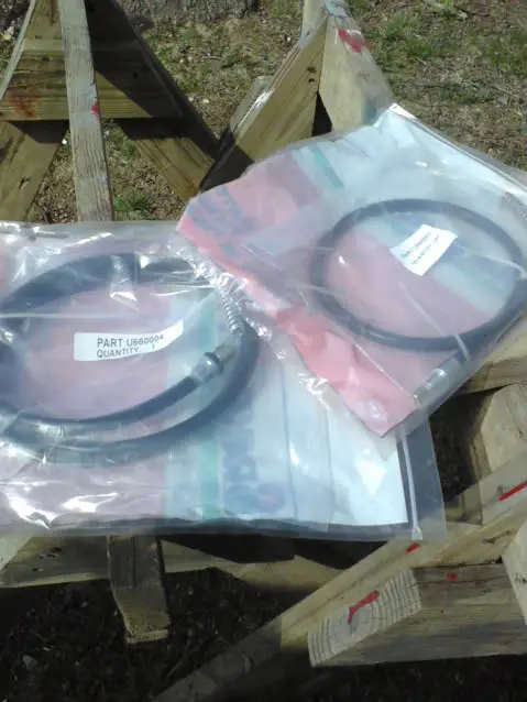

Went and got some new emergency brake cable to try and make a twin, one stick for each rear wheel. My idea is to be able to use one side only or both for a standard type emergency brake.
I know I have a locked rear in now, but I do have an open rear also and may go to an air locker so twin sticks will go in.
I purchased the set that comes for the Ex rear axle. But after checking lengths, I'll take the short one back and use another long one.
My idea would be to have both handles between seats and just to the rear of the seats.
