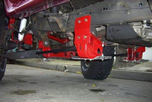

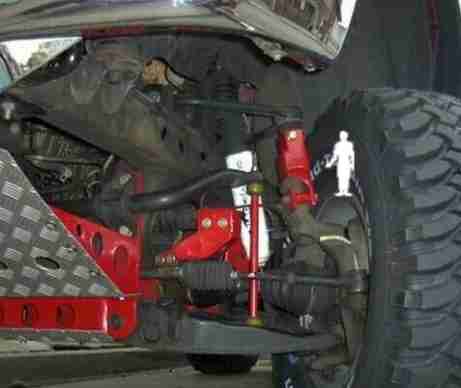

Okay. Trying to figure some differences out from 95 to 98 so I can figure out what I have to do to fit the 4" Superlift on the 95...
So included here are pics of a custom lift that Fenix has on his 95 or 96. I think it is a 95. And a pic of StadX2's front end with the Superlift. Notice the difference...What is that.
Does the Superlift come with an extended one of those?

The first picture looks like a trailmaster lift, while the second is a superlift lift.
The differences you can see are that the trailmaster uses a ball joint spacer w/ stock spindle, while the superlift comes with new spindles. Also the trailmaster drops the steering linkage 4" where superlift leaves it, and adjust for it at the spindle.
Actually Trailmaster attaches a steering slide under the rack and pinion that goes through the front cross member. The steering slide is attached to the steering knuckle. I have this set up and DON'T LIKE IT. The superlift extended steering knuckles are superior to the ball joint extender/ steering slide methode.
Well, according to the post Fenix says he has a custom lift on his 95 (painted to suit) RED.
Considerably cheaper...possibly fabed in Argentina by a friend of his. I don't know as I have not communicated with him.
Second Lift is a Superlift. Considerably more expensive.
As well I am wondering about the drop down brackets for the torsion bars. The "Custom" jobbie looks like he just extended the bracket.
So what is better. Having the steering dropped or not. I would think that the new spindle is more stout. Though the angle of the steering seems greater.
Your feelings??

Yup, that is Fenix's Exploder. From what I can gather Fenix and pals fab this up in Argentina, then customize it for you depandant on color.
To the best of my knowledge (limited I might add) it is a version of the TM style lift.
So where's the customizing? The color?
Color from what I gather. I don't know if they will do more, or if so what they could/would do to make your lift 'custom'. So yes, I believe it is only the color of the paint on the actual lift parts.
