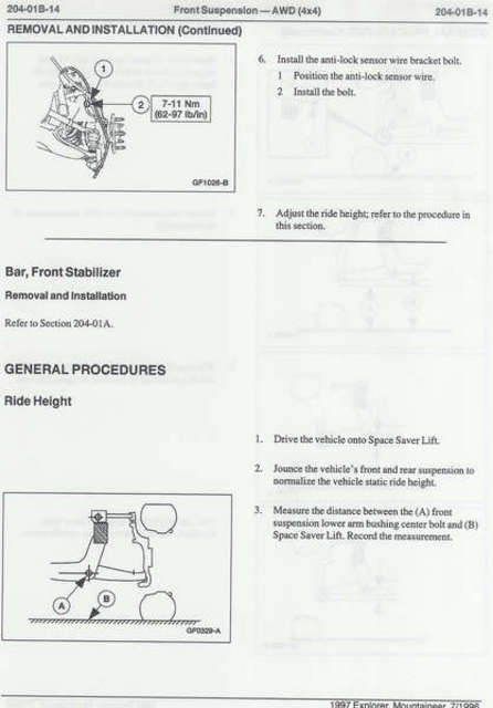

I think my 95 xlt was lowered by one of its last owners, how would I tell if it has or how much? what should it be riding at?
its a 95 xlt 4.0 auto 4x4 4 door stock wheels and tires and about 160,000 miles.
ive seen alot around and they all seem to sit higher than mine. Im not looking to go off roading with it but i would like slightly larger tires and would also like to step up to 16 in wheels. i think i can get what i want from a TT and shackles in the back. any advice would be great, thanks.
