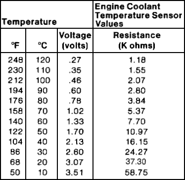

if this helps any,my explorer now has 91,000 miles on it and i had to replace my cap about 2,000 miles ago.was losing antifreeze.and i know it never lost any befor.you could use a ohms meter on the temp sending unit....probe the wires while its running..you should get a steady reading on cold and the hot temp...if its all over the place then theres your problem.not sure on the values..maybe someone else can jump in with that.heres something to try...top off the radiator,make sure its just below the neck,drain your rad overflow basin(follow the hose from the rad to the basin(make sure its empty)now go for a good ride n get it nice n hot .......open hood look at the basin...if it filled up with some fluid its a sure bet you need a cap.
Resistance chart for sending units. There are two sending units. One is for computer, one is for gauge.
