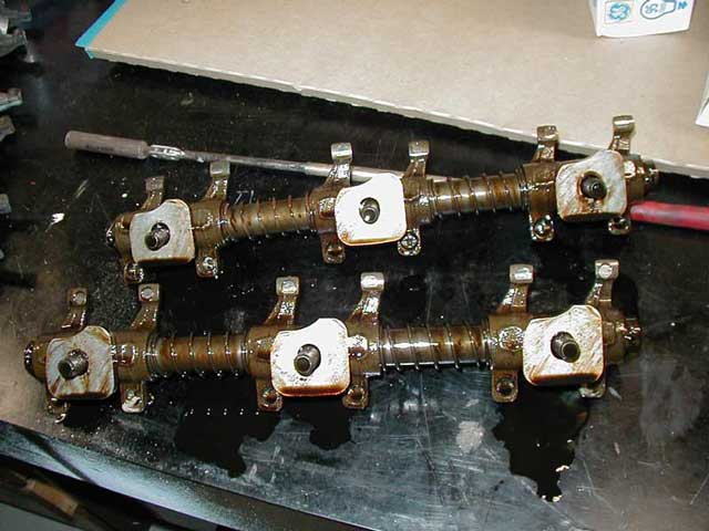

The rocker arms are an "assembly". There are 3 bolts per side. You tighten them down tight to the pedistal(sp?). I don't remember the torque #, but its pretty tight.. being too tight won't make the valve not close, it would just break the bolts.
Here is a pic of the bottom of them.. you can see how it is just an "assembly".

I'm not sure if its the assembly, I did follow proper torque for them, I wasn't sure if it made a difference at all in valve lash.
