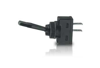

Three prongs? Is the switch lighted? If so, it's likely the prongs are power in, power out, and ground (I can't be 100% without seeing the switch, but this would be the most common). If not, you may have a double throw switch (on/on or on/off/on). Check for initials like SPDT or SPST. Here is a SPST non lighted switch. It has two connections.

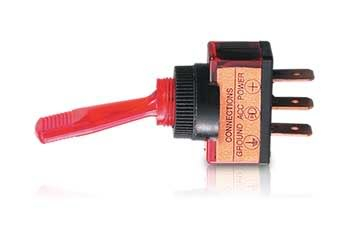

This 2nd switch is the same, but it is lighted and therefore requires a ground for the light in the switch.

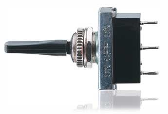

This third one is not lit, but will control two circuits, a 1 on or the other, or 1 on, other on, both off. It's usually wired with power out, power in, power out.
You need one of the first two types of switch but the third will work, just tape over the third connection.
