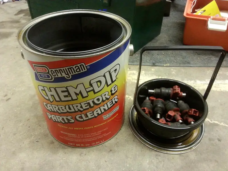

I'll soak the injectors in carb cleaner for a couple days. Now, I'm not exactly sure how long you should do this for..... I've forgot about them before and left them in this solution for a couple months - and I'm not kidding, yes they still worked fine.

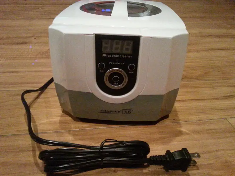

After this, ultrasonic bath. I got a new one for X-mas. I'm about to find out if it's better than the Harbor Freight one's I keep burning up (by my own fault). I've done some modifications to them you're not supposed to do.
Berryman's Chem-Dip like you showed is not supposed to be used on plastic parts; I worry it might make the plastic brittle or break down.
When I soaked my injectors, I used a tupperware container (sorry wife) and a can of Berryman's (same brand) fuel injector cleaner. Worked well.
B12 Chemtool like you showed is not supposed to be used on plastic parts; I worry it might make the plastic brittle or break down.
http://www.berrymanproducts.com/products/gasoline/b-12-chemtool-carburetor-fuel-system-and-injector-cleaner/
I like it. It probably is better. I have multiple sets of injectors I haven't serviced yet, I think I'll pick some up and give it a try.
I haven't noticed any brittleness or breakdown of the plastic from the Carb cleaner, other than the almost 20 years of age have done.

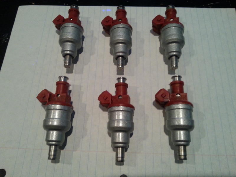

They've been soaking a while, I don't think it's necessary to do it this long but I've been under an overwhelming workload here lately and haven't had time to tackle this. I finally got a chance to use my Xmas gift ultrasonic cleaner. It's much stronger than the one's I purchased and modified from Harbor Freight. The Harbor freight one's are great for the money though, not dogging them.
The set I'm installing were pulled from a salvage yard, reconditioned as described above. Other than being a high mileage first Gen, I have no background on the donor injectors or vehicle(s). There's also no telling if the 6 I'm working with even came out of the same vehicle. I hoard these as well as other expensive electronic parts for the Gen's, maybe even soon to be unavailable as the vehicle ages.

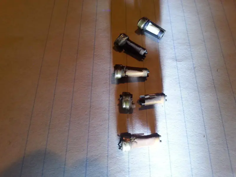

The one's I reconditioned were some of the worse I've seen as far as filter screens are concerned. All but 1 were deteriorated to the point the filters had decentigrated. I'm sure some of the contaminates outside the usual crap that makes it past the filter include tiny pieces of the screen. In case you're wandering, I remove the screens prior to soaking or cleaning them, so the carb cleaner is not the cause. 1 injector was purchased rebuilt at some point in time as you can see the filter is in good condition and it's like the one's I buy.
Now, I have a question...... I think it's relevant to this thread. It's about using talcom or baby powder to treat the intake manifold gaskets prior to reassembly in order to keep them from sticking so you may reuse them if so desired. I've heard of it, haven't researched it much, but was curious if there are any qualified mechanics that can chime in on this? Just FYI, I am not a mechanic, only a tinkerer. I have never been employed as a mechanic, I'm "Internet Qualified" and built my own setup for Inejctors, so take my advice with this in mind. I am a Business Software Developer by trade, and an Automation Engineer, not any type of certified mechanic. I just enjoy picking up a wrench on the weekends, it's therapeutic in an odd way. I know the first Gen up and down, so I stick to what I know and make sure it's well maintained.
Her's some photos, aren't they beautiful?
