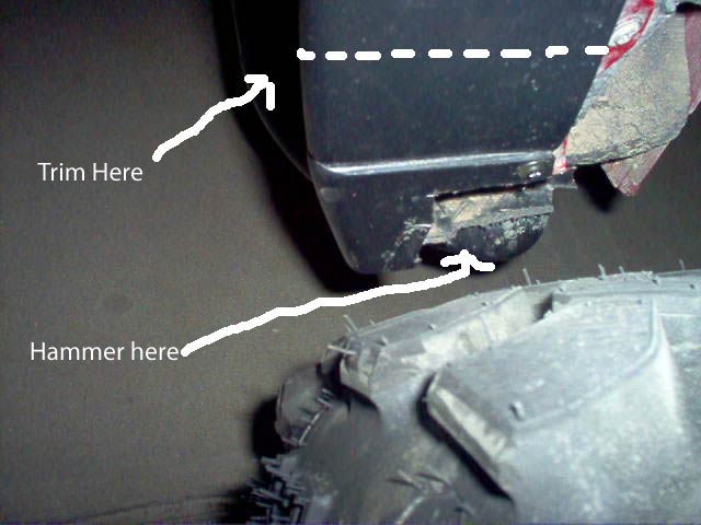

Well I have the 2" BL and about 1" TT....I trimmed all the places I need, and now the only time my tires rub is when I am taking a turn while stepping on the brakes....is there anyway to fix this? It is only rubbing on the bottom corner fender...here is a pic...
Thanks!!
Yup.. just trim the fenders.. Getting a 15x8 with 3.75 will still cause it to rub since it'll pull the tire out 1/4" more than the stock rim.

Cut that ####er out...prob solved

Well, can anyone tell me what is behind the plastic fender piece?....how are deep can I cut out?.....and what is that foam-rubber piece in the top-right hand corner?
When I put on 32's I needed to Sawzall the front chrome looking plastic a bit, but I just used a big hammer to fold back the rear part of the front wheel well.
I trimmed that black plastic off with a Dremmel tool, like the picture. I didn't have to cut any metal, I just cut out some plastic and banged away with the hammer. The foam stuff you can just push in or take out.
Then just turn the wheel to give you some swing room & massage the lower lip of the wheel well up & in.
