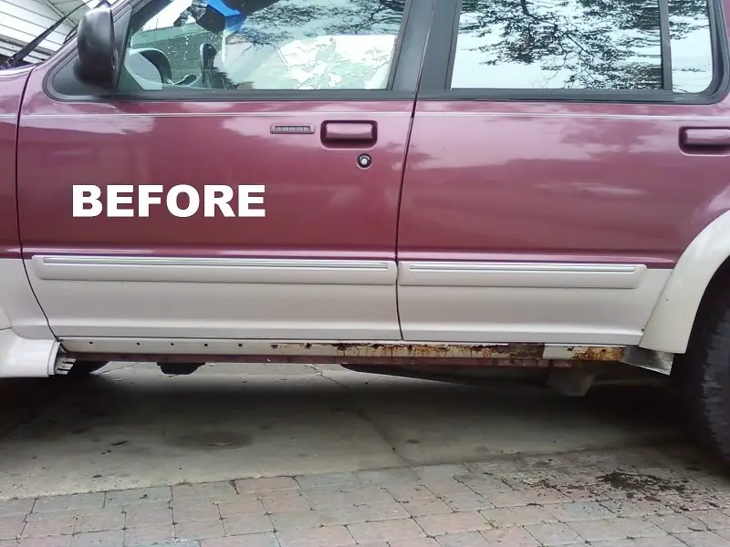

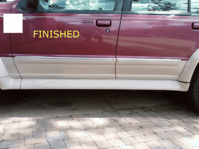

I have a quick cover up if it still has some rigidity. Installs in minutes, and looks great. I would seal it the best you can with POR15 or similar to stop it from getting worse. Heres a youtube video I made detailing what Im talking about.
that doesnt actually fix the rust you know.. it just buys you time before the rust gets even worse and harder/more expencive to replace
i have seen several people doing that, sure its cheap in teh short term but you are just going to have to replace twice as much down the road. then again sometimes there isnt too mcuh choice, my dad fitted tin plates to fit the contours of the corners of the Ram to seal the giant holes left by rust so it coudl pass inspection... looks terrible, wont last more than a year, but oh well.
