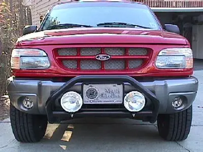

heres a REAL old pic of the front of my truck
i know it s 99 but you get the idea. heres the mounts for my other bar, but they are very similar
Thanks for the pictures. That definately is right where I'm mounting my hooks. I guess I'll have to put my tow hooks on hold and find a new mounting spot once I get my safari bar. Thanks again.
