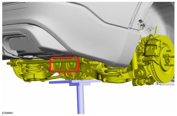

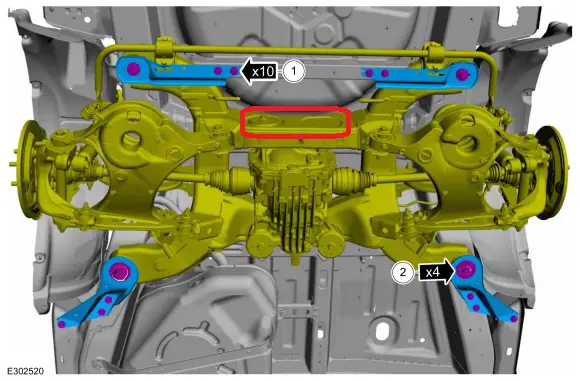

Here's another few items to add to the weirdness. Here are a few screen grabs from the Ford Explorer Manual
There are two views of the rear subframe - one with two bolts and one with one bolt. Go figure.
