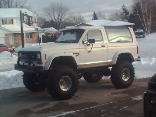

Here's a little inspiration for you. I'd like to do a full write up of this bronco with my Father-In-Laws permission (it's his).
'84 Bronco II EB
'86 Mustang GT 5.0L, Holley Fuel Injection, L&L headers, high performance everything, punching out 400 horse.
C4 trans HD, with shift kit
Dana 20 transfercase
Currie HD Ford 9" rear with 4.56:1, Detroit, 325 spline axles, disc brakes
'77 Ford Bronco Dana 44 with Warn axles, Ox Trax locker, Ox Trax U-Joints, Warn Hubs,
38.5x14.50-15 Super Swamper TSL/SX on 15X10 Prime wheels, all '76 bronco suspension
I'll write up much more later, just don't want to take away from Muskrat's thread.

hey, hi jack it all you want:D, this thread is worthless anyway, no finished project
Nice BII I used to have one too, not quite as pimp as that one though.
I miss my B2, that thing would have made a good project
