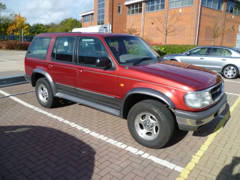

Here is a pic of mine with 2" lift shackles made by kevp. I fitted the shackles then wound the front torsion bars to match. Kev p also supplied a bracket to alter the position of the ride height sensor for the ARC system so this is aldo something to consider.

The bracket for the ride height sensor is it needed? If so what would be the outcome for not fitting it?
Hi again
If you lift the rear somewhat, the sensor will think it is too high and will try lower it by deflating the air shocks some. So it will drop the rear back down and the shocks will be softer.
The bracket is just a plate with a couple of mounting holes and then a couple of holes to remount the sensor 1 1/2" higher up.
