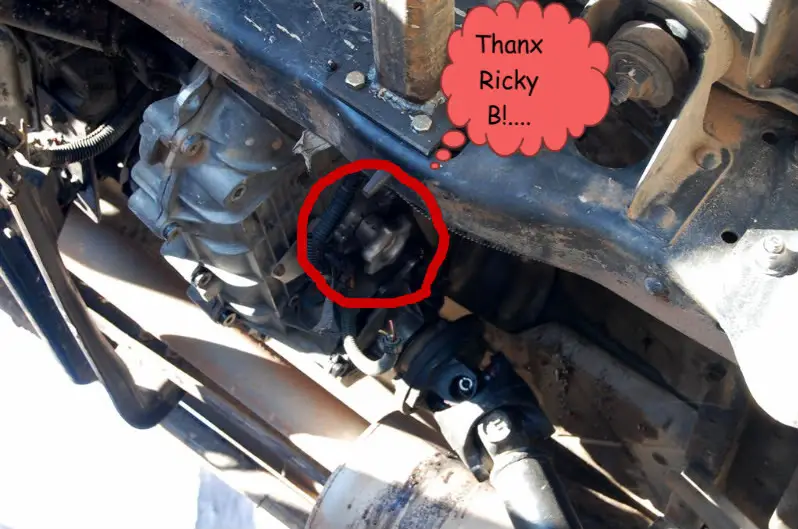

ok so it wont go into 4low but 4hi&2hi are fine i pulled off the shift motor from the tcase and hit the buttons 4x4 goes in position just fine but when i hit 4low(neutral,foot on brake,clutch disengaged,in 4x4) the motor just snaps back to 2hi position. is there a way to rebuild the shift motor or am i on the wrong track? any help would be appreciated this is my first x. let alone my first 4x4. thank you

Look under explorer/ranger transmission, transfer case and differintals. Brian has posted an excellent sticky on rebuilding the shift motor. Save you cost of a new one.
Just a friendly little reminder to you newer Explorer Folkz here, this gadget of ours may be the best $60.00 trail repair part you ever buy-----or even as a full time alternative like so many others have done. Really, it's pretty damn easy to operate and is bullet proof. Just takes a little pre-planning on the users part, so that they get their front axles locked before they get too far into the muck.
