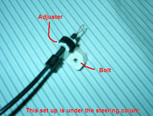

There is an adjuster wheel under the dash. You gotta take off the plastic and metal piece under the steering wheel (not the steering column covers) I will post a pic in a minute.
This is what the set up looks like under the dash. It will be bolted really close to the steering column. The other end of it comes out of your gauge cluster right by the gear position indicator.
