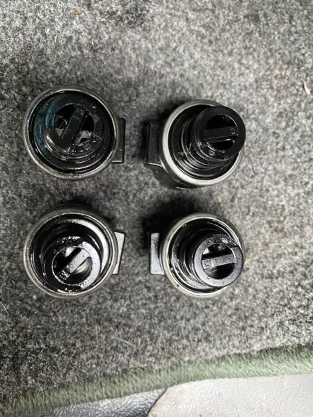

The replacement solenoids I used to replace the old solenoids don’t exactly match the Bosch ones in the ranger. The slotted openings do not have the same orientation as the originals. Does this matter? I haven’t seen any posts indicating that it is important. The truck won’t shift at all anymore, so I’m assuming that’s what caused it to stop working. I did not replace the TCC or EPC, only the 4 normal solenoids.
These are the openings I am referring to in the last reply.
The shift solenoids are basic on/off devices unlike the EPC & TCC solenoids which are pulse width modulated. This means that they are at various states in the open position, and are considered high wear parts. The valve body gaskets near those solenoids get the most wear since there is constant low frequency vibration. It's a good idea to check the valve body bolts with a 1/4" drive In/Lb torque wrench when the pan is off while replacing the fluid & filter.
