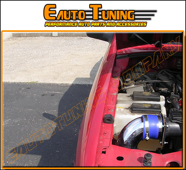

however i am contemplating going to a short ram intake very similar to this one:
http://imgs.inkfrog.com/pix/eautotuning/Ford_Short.jpg
it appears that the actual part that i would be getting is before the MAF sensor, therefore i would not have to relocate the MAF sensor, correct?
and also, is a short ram intake really worth it? am i going to see a difference in performance or gas mileage???

i wouldnt use one of those cheap china ebay intakes, they can be very low quality, and they come with poorly made filtering elemts, that can coat your maf in tons of oil, not filter well, and even slow down air flow.
and are far from an actual ram air intake.
now all this is worst case scenario, but some of them are like this,
if your making an intake, just get a maf adapter and buy your own good quality cone filter,
or get a real intake kit from someone like k&n or aem.
slam it on there and drive it, it'll sound cool and you'll like it.:D
If you don't, you can always go back.

the one i am looking at doesn't seem to be a cheap ebay one. it is slightly used from another guy who just totaled his explorer. i just used that picture as a reference.
but since the only thing i am replacing is just before the MAF sensor, i shouldnt have to find a new home for the MAF sensor, right?
no the maf can stay where it is,
if it looks to be good quality, id say go for it.
if you want to make it a good system, id recomend using the tube, then if you ever decide to replace the filter use the biggest dry flow synthetic cone filter you can fit, youll get more air, and you wont coat your maf in filter oil.
