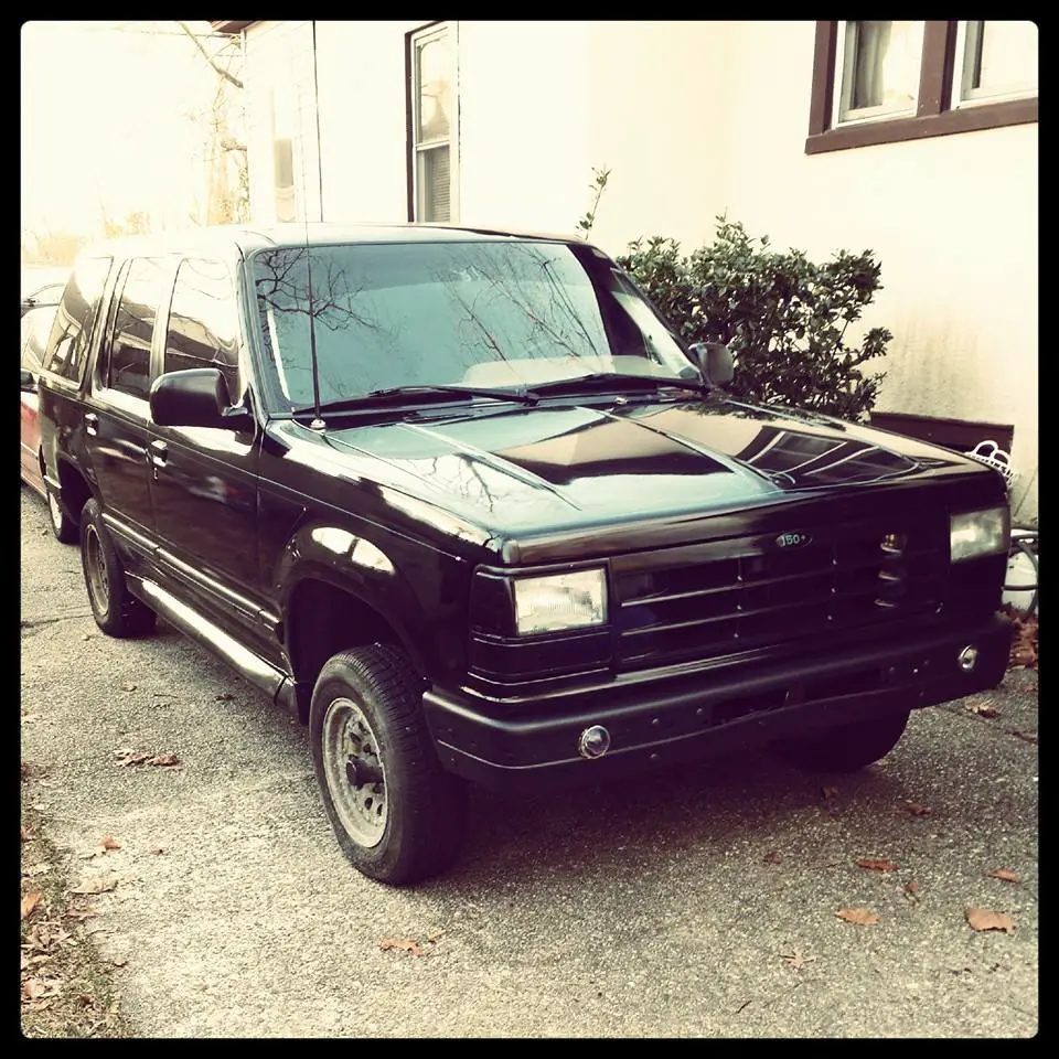

Hey guys, new to the forum and explorer scene but I plan on sticking around for a while. I have terrible luck with cars (my current dd is burning excessive oil after I put 1200 into the suspension and engine maintenance) so I picked up this 93 4x4 Explorer from my friend for $700.
He has owned it for the past 3 years only putting about 10k miles on it, leaving it at almost exactly 213k. He used it as his daily but he never had to drive much as you can tell, and he also used it as his audio truck as you will later see..It was originally a dark green, the previous owner repainted it himself 2 years ago. The roof is reinforced with I believe 3/4 inch plywood, as well as the tailgate and floor of the trunk for sound deadening. The front door panels are fitted with custom fiberglass to hold 2 10" voice speakers each, and the rears are fitted to hold 1 6.5" speaker and 1 4". Oh and it has a 250A alternator.

I plan to do a bunch of common maintenance that these vehicles need over the years as well as some custom work! More updates to come...but for now here is how she sits. (new larger rims/tires off a jeep cherokee are waiting to be put on, just waiting on my wheel spacers to arrive)

Welcome , Looking forward to seeing or hearing about the audio setup in it , The first gen X with the ttb front end normally wears out wheel bearings pretty easily, so that could be your wobble , also , they tend to eat tie rods if the alignment is not kept up with , Looks and seems like a pretty good rig so far , looking forward to more progress from it ! .
Thanks, will get more pics once I clean it up. New wheels going on tomorrow so I'm pretty happy about that. Sick of these tiny car wheels lol
Those wheels look like stock 14" Ranger wheels to me .
That's exactly what they are but they look so silly in these big wheel wells! Talk about tipping hazard lol..
yeah I figured they might have been 14"s , Bigger tires would make it better , but still wouldn't fix the looks of them lol
Haha yeah, u-g-l-y. Putting stock square body cherokee wheels and tires on it tomorrow with 1.5" hubcentric spacers because they didn't clear the brakes
I don't think the cherokee stock wheels will fit over the stock 4x4 auto locking hubs , but maybe the older ones might . make sure you try before you buy , or at least do some measuring first

Well thanks guys, the wheels fit great with the spacers, they were off of some guys square body cherokee but who knows if they were stock for that vehicle. Next up is getting some rear shackles to replace my rotted old ones (warrior 153's seem to be a crowd pleaser).
