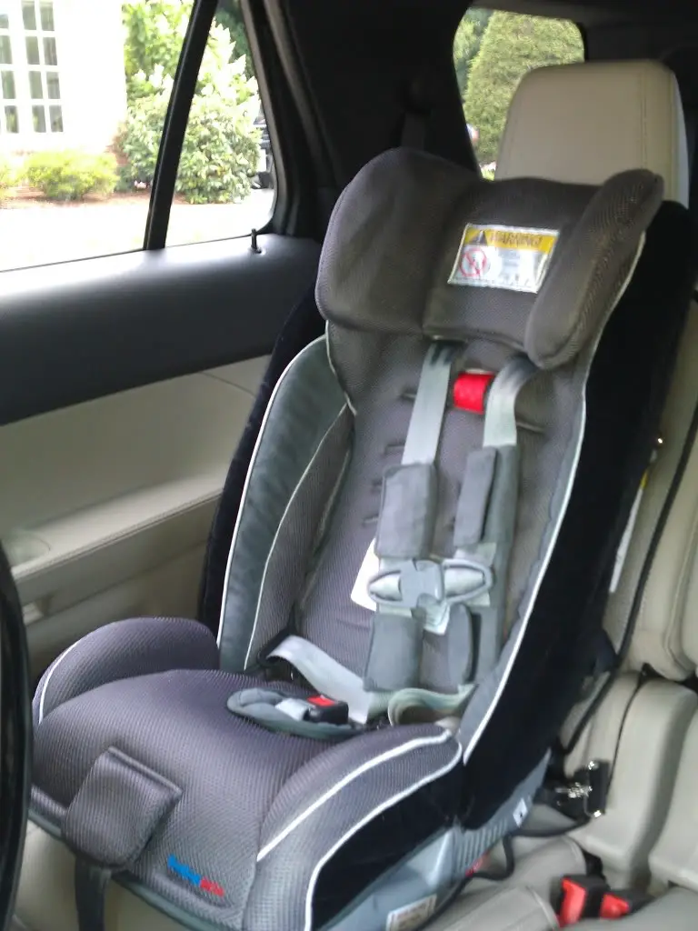

I just bought a Sunshine Kids Radion80 SL, and it's very narrow. It's advertised as being able to fit 3 of them in the back seat of a standard car.
Here is a pic of it on the 40% section of the 2nd row. It is very heavy, however, as it has a steel frame.
Thanks for the suggestion, harlenm! We did end up getting 2 of these and they fit fine in the 60% and the 40% folds down!!!
