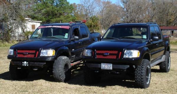

I personally will never do a Torsion Twist again. The torsion bars will fatigue over time and you will lose any lift you got from doing a TT.
With right wheels and some trimming you can fit 35" tires with just the 3" body lift.
Look at this picture below. My truck is on the left with the torsion bolts adjusted all the way in and my front end is lower than my friends Sport Trac on the right with no Torsion Twist. We both just have 3" body lifts. My torsion bars have fatigued over the years. And those are 35" Goodyear Wrangler MTR's on my friends Sport Trac on the right.
