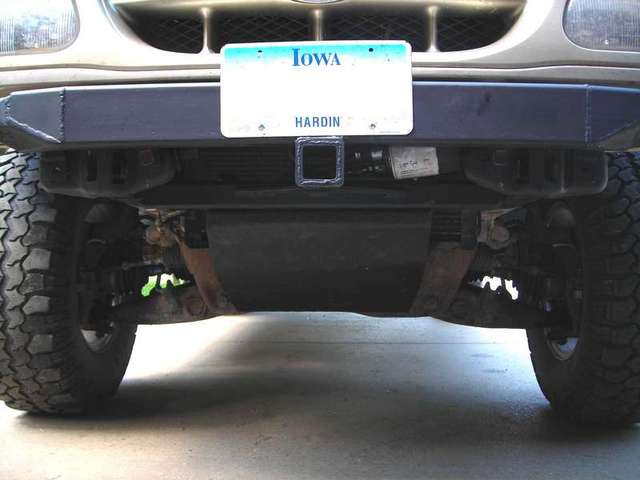

Front skid plate for the radiator, Gas tank Skid, some make a transfer case skid as well.
There are factory front and gas tank skids. From what I've heard the front really isn't too strong, but the factory gas tank skid is pretty good, at least the metal version of it.
Here is the front skid I made, along with the bumper. (Notice the receiver hitch for a front tow point. There really is not easy recovery point on the front of thses trucks unless you put hooks or a hitch up there.)
Thanks!
Really nice bumper! Have ju got any pictures or drawings of it?
