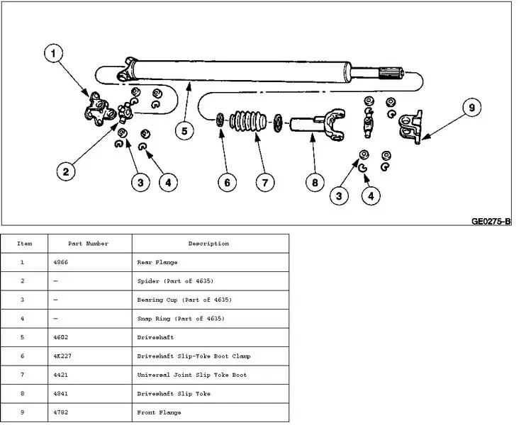

rear driveshaft assy

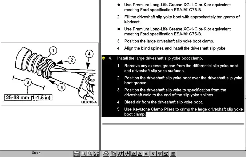

slip yoke 1

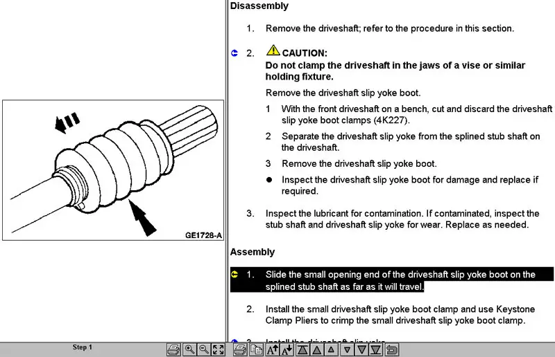

slip yoke 2

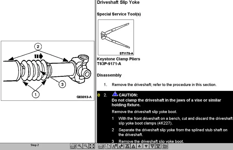

slip yoke 3

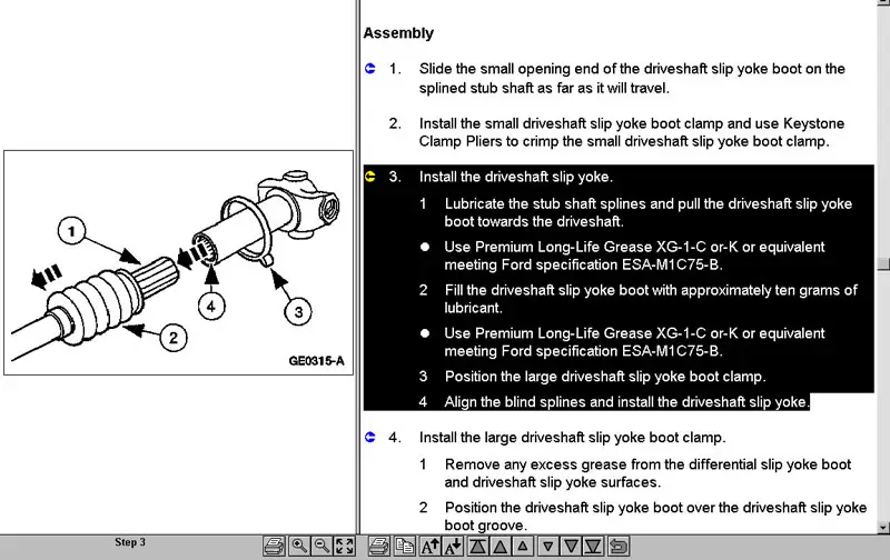

slip yoke 4 (last pg)
