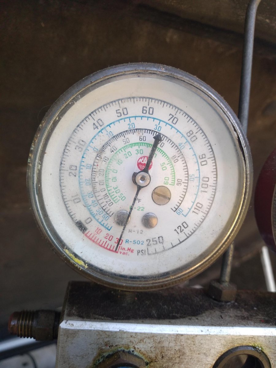

2000 Ex Sport. SOHC Vin E. Two summers ago the AC slowly stopped performing at it's normal Cold. I do mean Cold. This truck had the coldest AC I've ever experienced. I evacuated it and couldn't find any sign of a leak. Held vacuum, so I charged it. This year it is out of freon. Yesterday I evacuated it a couple of times. Then pulled it down and let it sit for 45 minutes. Needle on the manifold GA never moved a hair. What do you think, schrade valve.. ? I see no sign of leaks any where, including around the valves.

The ports (schrade Valve) could be the problem. with the hoses connected you don't have a leak. So replace them( valve). First you need too check there size, visually, before buy replacement. Or buy a universal kit on amazon.

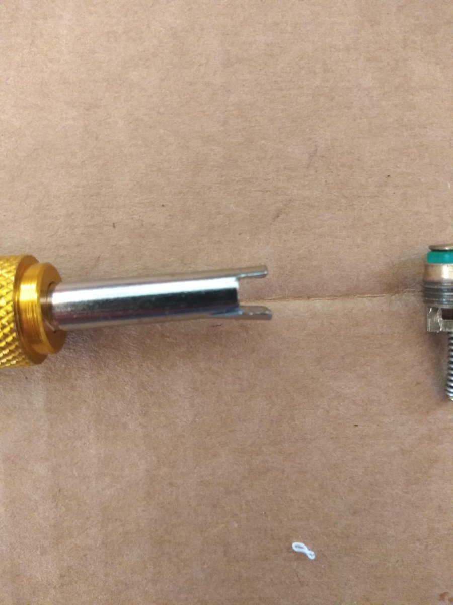

It was so tight I had to use a pair of mini channel locks on the removal tool to break it loose. Then I find no exact match for the high side out of 64 pieces in the kit.

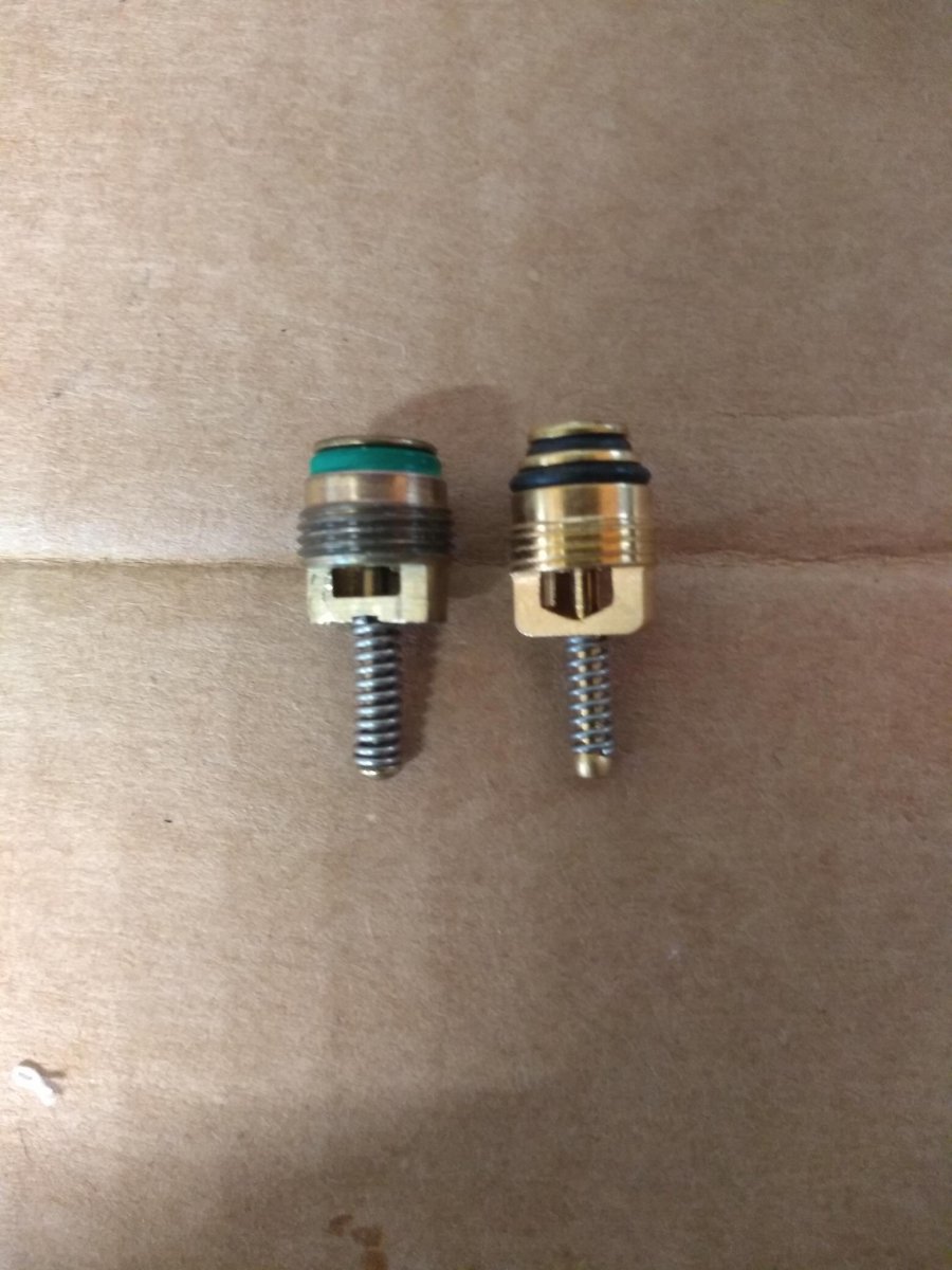

Pictures of the closest core I have. The one with the green seal is the OEM. Not sure if the replacement one will work ? Thoughts.
Notice the tool, bent it on the side the torque was on.. Cheap import.. Grrrrr
The high side replacement valve appears to be universal. It looks likes your replacement valve will work or go over to your local ford dealer, and see if they have the valve in stock? The valve will either seal or not.
I'll just try the replacement one.. Nearest Ford dealer is a drive and its a very small dealership. I bought a new Ford Escape from them in 2009. I learned how different things are here in the rural South. Let's just say compared to what I was used to in MA they are not real impressive. I was the service manager for a independent shop up in MA years ago that was a far larger operation than this Ford dealer. I live in the boonies.

I could have called I guess. Had the Ford PN off Rock Auto.. Motorcraft price $10.00.. I installed the one from the kit. Put a little freon in, engaged the clutch and used my sniffer around the valve. No sign of a leak. I believe you were right "universal". Charged the system up and it's ICE cold again. Took it for a road test and then went all around with the sniffer. including the vents. No alarm... I'll see how long it lasts. Maybe go around with the sniffer once in a while..
