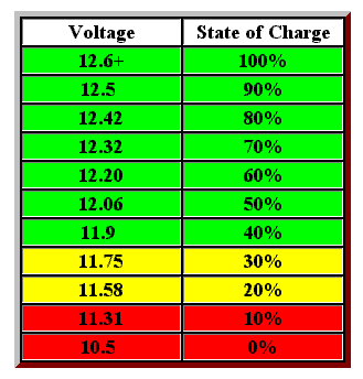

A rested fully charged battery should be around 12.6 volts... At 12 your only about 50% ...Im old school if you think the battery's okay disconect it while running with lights on it shouldn't stall, if it does look at alternator...
Here's some charts...
