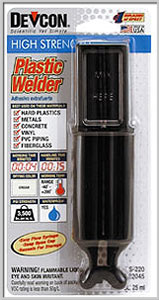

either way take it off and use some two part plastic epoxy(the good stuff) and that sould keep it together
This stuff works great :thumbsup:
