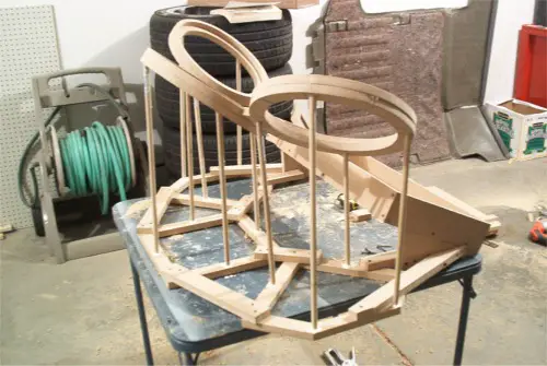

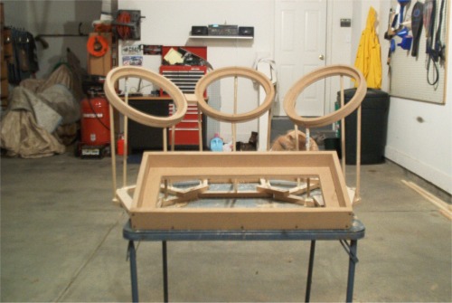

Here are some pics of the fiberglass box I'm making.

How do you make those circles? Are those bought pre-made or did you make them yourself?

X-Factor, i tihnk you cna buy those pre maid
To build the sub rings I made a circle jig with a ruler. You basically nail the ruler to the wood, drill a hole out on the ruler depending on the size of the circle you want, and just put your pencil in the hole and draw it all the way around. I cut them out freehand with a jigsaw. My Rotozip had a circle jig built in but it was too small for my needs.

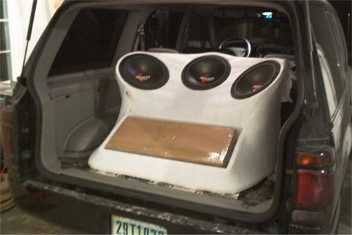

Fleeced, almost ready for glasswork.
:eek: Looks good...... looks like you will be running a LONNNNNGGG amp, is that one of those big Kicker amps??

Damn, that's gonna look soooo good. No-boxy look there. ;)

how much does fleece run you? I can't wait to see that thing finished

Ummm ok. Fleece runs about $5-6 a yard.

Hartman, that's coming along nicely man. You going sealed? VR1000 or some other huge amp going there? Don't tease us man, details!! :p
I started planning this project way before typhoon posted construction pics of his. I guess only one person is allowed to have a fiberglass box.
The enclosure will be sealed. The amp I'm using is a 04 model Kicker KX850.2
