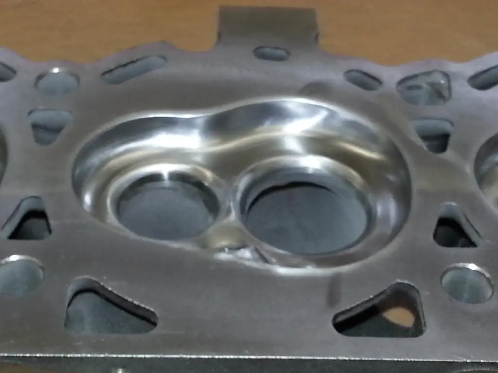

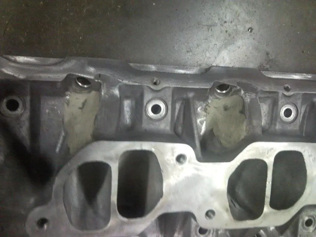

These are ruff pics..I also polished it to a mirror. I had mine ported to the max, to get them to flow right I had to come out the sides to straighten them up.but my port work I take basically to the max and have spare parts if the flow doesnt increase or if I mess the parts up..

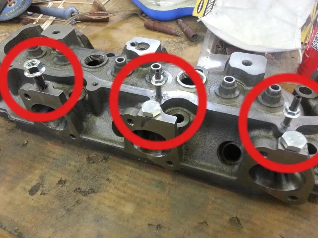

And my heads...if you dont need these bolts you didnt port enough. ..
And my cc
Thanks for the picts! That is what I am planning on doing to the intake (except that I have no experience with epoxy- so I hope not to grind that much material out further up). Wow- those chambers look phenomenal :)
I don't think there will be much gain in porting on this motor. If you were to put a bigger camshaft longer rocker arms added headers making the ports bigger will most like hurt performance then gain any. Taking all the material out of the chamber to get it down to a Polish. If you didn't have the heads milled after you just made the chambers bigger which just lowered the 9.1 compression to 8.75 which lost you HP.
Most people would port unless you are doing a cam or other motor work..this motor is soooo restrictive and port work mostly helps.the biggest thing is how small the valves are..and from personally experience you would need to remove ALOT to lower compression to where it would hurt over the gains..yes milling the heads and making sure all cc the same is important. .
