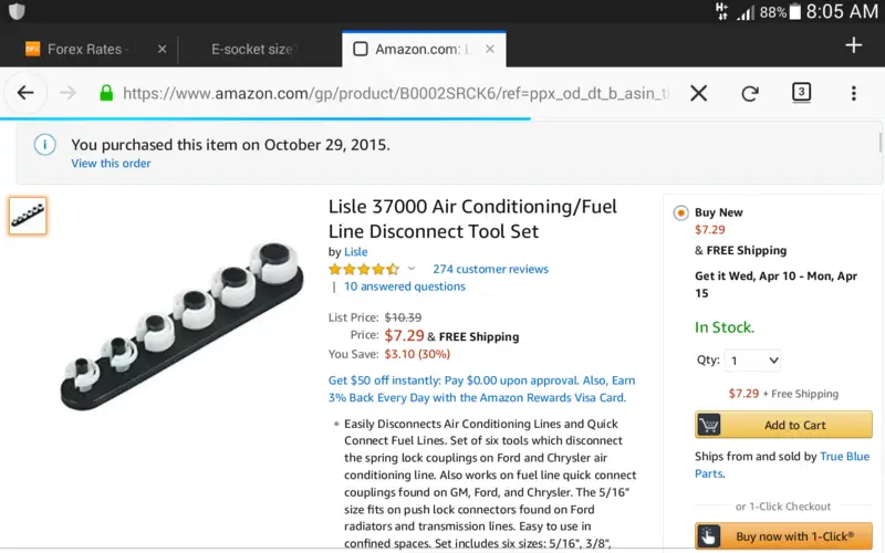

This spring lock set works well for fuel/ac lines.

This spring lock set works well for fuel/ac lines.View attachment 169043

makuloco said a 3/8" disconnect for the fuel line fitting. I'll try the metal tool I have first. I never have much luck with the plastic ones, though I think I have a set of those too.
I recharge my ac myself, more than once and the plastic set is fine. It doesn't damage the spring inside the fitting

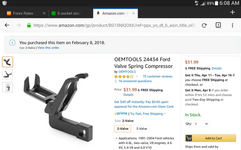

@david4451 - Did you use the following OTC tools for for cam timing and cam follower removal? If necessary I'll have to buy these, but I'll see if I can borrow them, because they'll cost me over $300 U.S. and I guaranty I'll never need to use them again once this job is done. There is a less expensive cam service kit, but I don't think I want to take a chance with it (too important to get this perfect). Also, I don't see anyone offering a Felpro full gasket set for the 4.0L SOHC. Who did you get your gaskets from? Buying gaskets individually can be expensive, as compared to buying a full set. Did you use a Motorcraft gasket set?
Cam follower removal/valve compressor tool OTC 7928:
(This looks like what fordtechmakuloco used in his video, but I have to watch it again to verify the part number).

Hi Phil, I used the OTC6488 cam timing set, did the job no problems.
As for the cam follower removal tool, I used one shown in screenshot below. It's tricky to use on front right and rear left valves and to get it in you have to rotate cam shaft a bit. On all valves you have take pin out and assemble in place and put pin back in. I reground all valves and new valve seals.

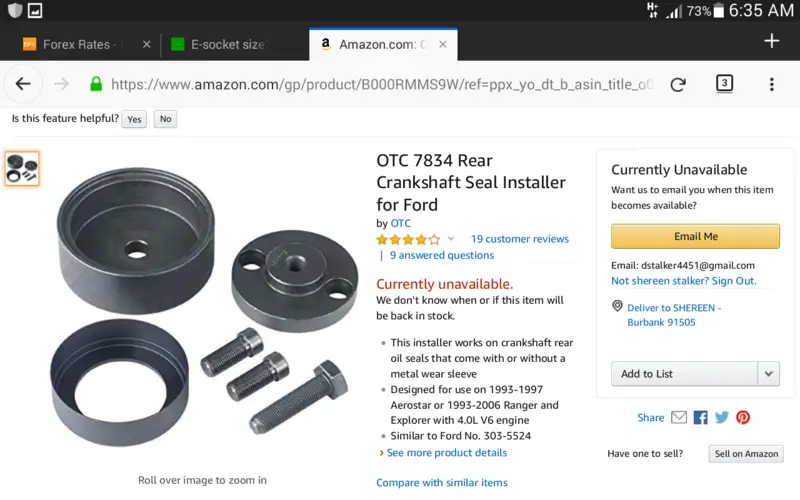

It got expensive for me as no one to borrow tools from. You may also find you need a rear seal and sleeve crankshaft tool. Screen shot below
David, In searching my local auto parts store's loaner tools on-line, it looks like O'Reilly's may loan the OTC valve compressor tool, so that will save me a little money. In the tear-down video I watched from fordtechmakuloco (FTMUL for future reference) he discusses the 2 valves where the tool wont fit and how to get around that. No one lists the OTC Cam Service Set. Next week I plan to ask my mechanic buddy if he has cam service kit and if he's willing to loan it to me. If I have to buy the OTC Cam Service Kit I suppose I can sell it when I'm done and re-coupe a little of my money.

I'm now looking at the big shiny stainless steel fuel line connection (looks like a stainless steel check valve) between the engine and the fuel filter (I'll post a pic of what I'm talking about later). At first glance I don't see how this thing comes apart. @david4451, you said you used a 3/8" plastic disconnect tool on yours, but I don't see anyplace to use the tool on mine. Mind you, I didn't get a good look at both sides of it yet. FTMUL said to leave this fitting for last in case fuel dripped out while you're heating up the EGR tube nut on the exhaust header with a torch, but he never showed how he disconnected it.
Fuel line connection is disconnected with plastic " tool ". The spring inside is spread by tool, pushing it in to fitting, holding it there and pulling apart. They are called spring lock connections. Leaning over left hand wing on truck tool is inserted into left side of fuel line connection. Can be tricky, once you've done it a couple of times its not so difficult. It's also requires quite a bit of pressure to reassemble.
