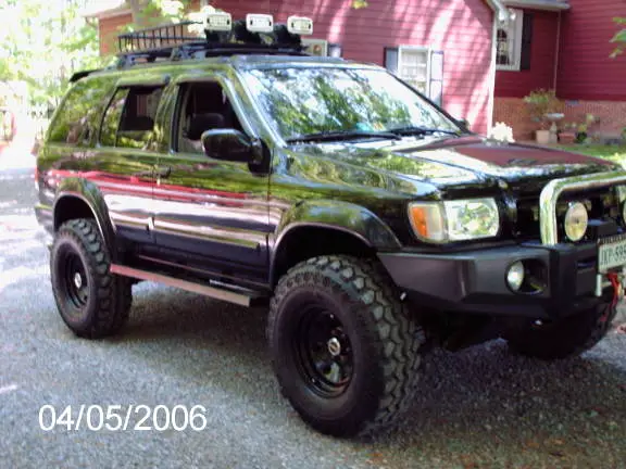

I had warn premiums on my 2000 infiniti, which is essentially a rebadged nissan pathfinder with more gadgets and comforts inside. There has to be a way to convert a sport trac. I only researched it a little so far but it looks like slightly older ford models had non-live axles that can be interchangeable so we should be able to fit manual hubs on the front with a little modding.
